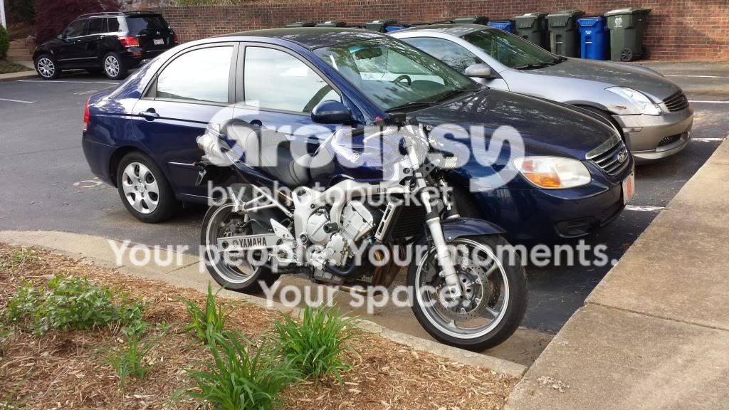

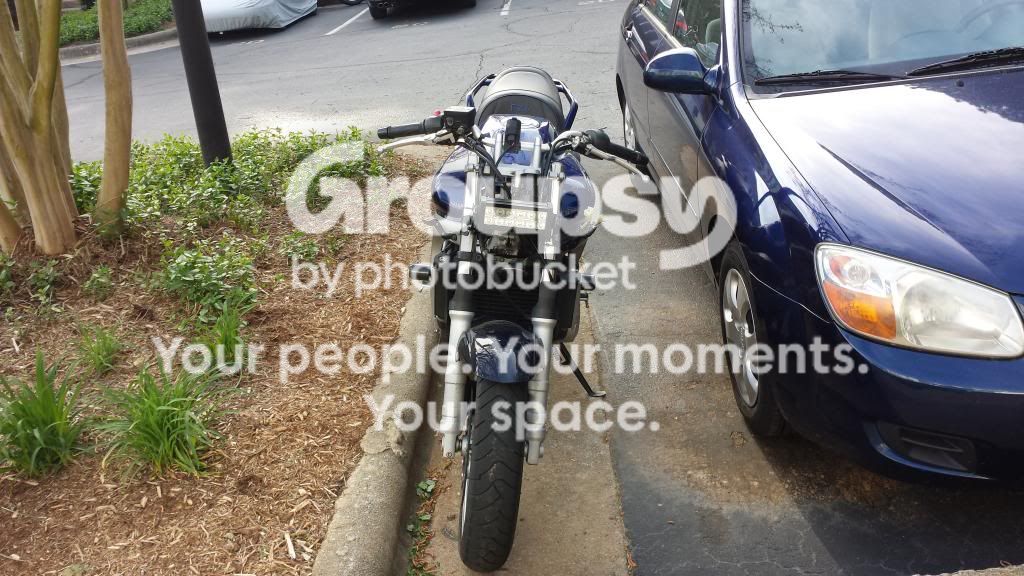

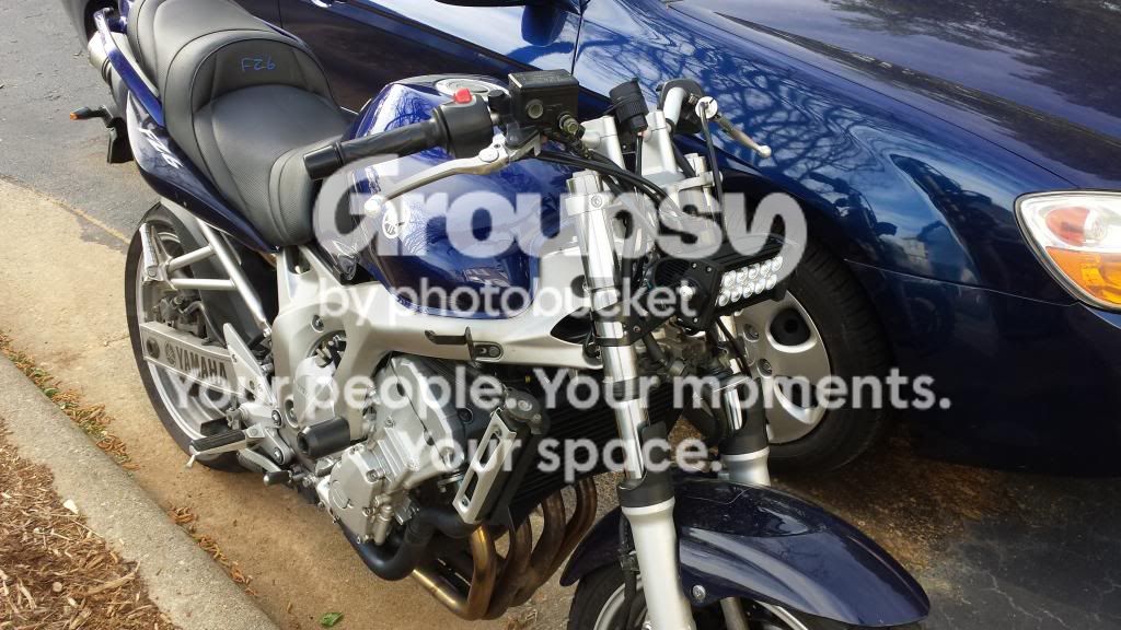

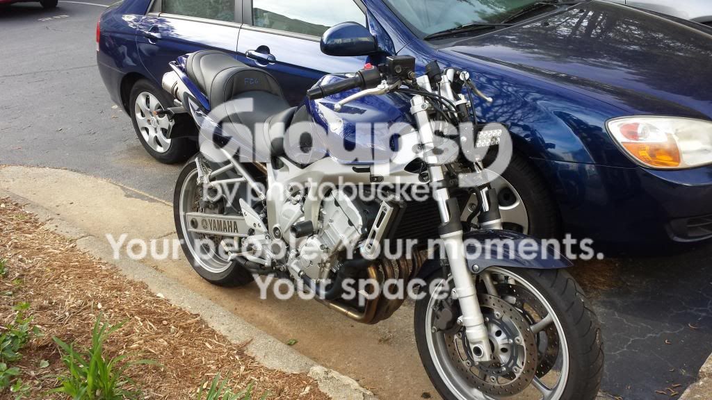

So I got my light bar today and decided I couldn't wait so I ripped the old off and threw her on there. Keep in mind that this only took me about 15 minutes total so I still have a lot of cleaning up to do. I did this just as a start. I plan on making a bracket that goes over the top of the light bar to mount the speedo and turn signals to. Will also be adding some bar end mirrors. All that being said... I love it. And the more I stare at it, the more I love it. I think it looks completely bad ass.
I have not tested light output on the bike at night yet as it is not wired up yet. I will probably wire it up sometime later this week and I find some time. I have hooked it to a battery thought and it seems like it should work perfectly fine.

Anyone have suggestions for a windshield/flyscreen that will match up with the led bar? i have been looking but cant really find one i like. The closest i have found is the buell but i dont really want to pay 100 bucks for a piece of plastic.
Light output is decent. It really iluminates EVERYTHING in front of the bike excellent. The problem is it is rather easy to out run the light with my visor down. I have a Shoei qwest with a blacked out visor. It was difficult to see with the stock headlight at night with the visor down so I am rather used to this. With my visor up, I have no problems at night what so ever.
