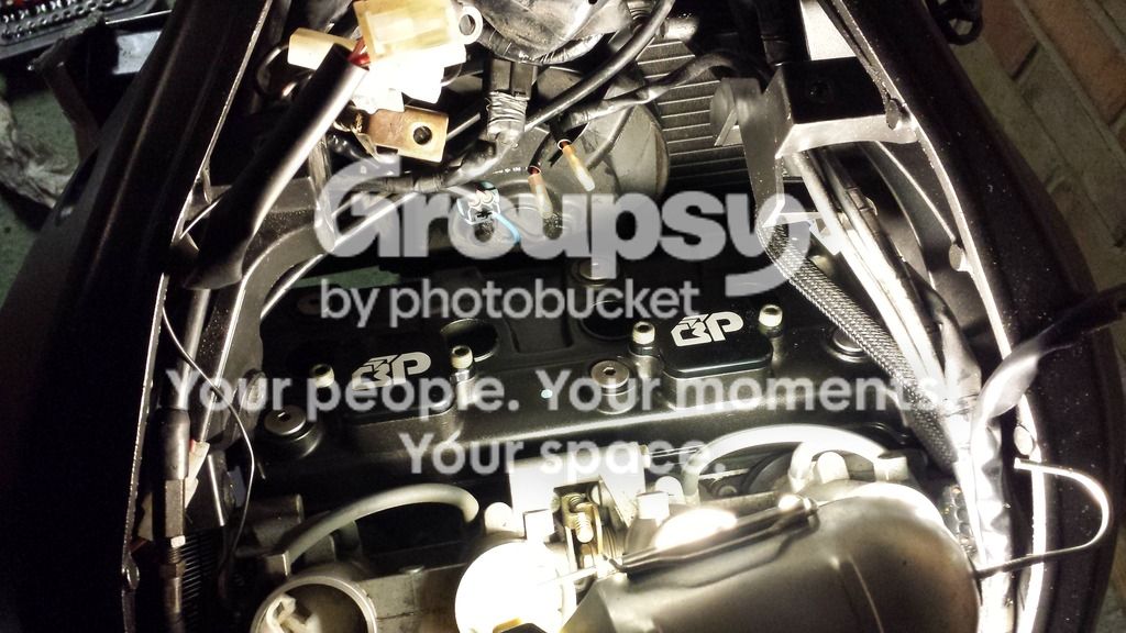

Blanking plates arrived. Fitted those:

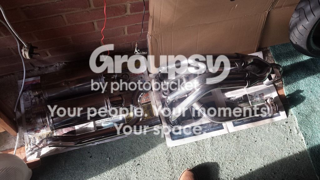

Fitted the coils, rubber cap battery box, airbox etc back on the bike. Also fitted the downpipes which I had off for polishing:
Stuck the battery in and fuel tank on and went for a start up :D.

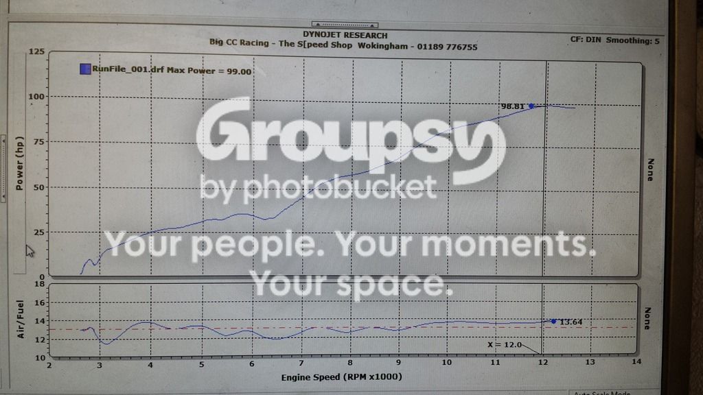

I'll get in on the dyno, I've got a before graph as a rough comparison.
Hoping it'll pick up some in the midrange and will see 100WHP.
Also hoping the custom map I've got won't need too much tweaking.

I'll stick up a copy, don't think it has the AFR listed though which is annoying.

I've pulled out the before dyno sheet I have and we can use that as a comparator. Just for reference on that one power is dropping off from 12k.
I'll get an afr trace done with the pulls. Can see if the flat spot can be calibrated out by playing with the fuelling and what gains there are left By tweaking the fuelling.
Then if it's still there it might be time to have a play with the cam timing and see where we get to.

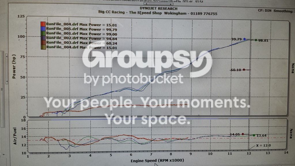

Right well.
SUPRISE!!
Highest was 99.79. Fuelling is all over the place as you can see as well as that massive flat spot.
Guy reckons we'd probably get to 105 hp at the top end Once it's mapped.
Result I'd say :D. If that flat spot goes obviously.
