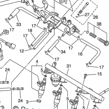

I don't have the equipment needed but I can get it, I wouldn't have thought that would have been an issue with the brand new fuel pump that is only 200 kms old and it rode great until this issue

I wonder if something is restricting the fuel flow. May be you can check the fuel line and fuel rail for obstructions. Did you use an OEM fuel pump or an aftermarket unit? If it’s aftermarket perhaps it has experienced a premature death.

Sydney, Aus
It's an after market unit from a reputable shop not Chinese junk. It has plenty of flow from the tank to the rail, beyond that I can't test currently or see. I had pulsed and cleaned the injectors while they were out so they were working. Unless there is in issue in the rail...?
