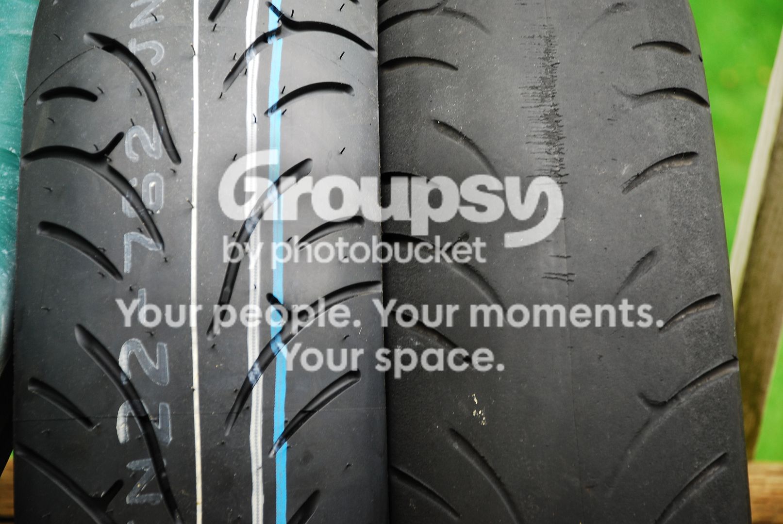

I bought my bike early 2014 (2009 FZ6), bike had fairly new PR3's installed. Since then, I've put roughly 7k miles on them. They are due for replacement and I noticed an odd, uneven wear on them (see pics). I see 2 issues, uneven wear and cupping. I think I can fix the cupping by adjusting rear pre-load, but what can I do to address the uneven wear? It's consistent front to back.

The lack of rebound damping shows on the rear. As for how you wore one side off, I'd do some checking to make sure rear wheel is tracking straight ahead. Doing the String Alignment comes to mind. Has the bike ever been down in an accident?
JM2C, but because the center tread is gone, the feathered edges are moot point as you still have plenty of tread.
+1 My thoughts as well. I bike with a mis-aligned rear wheel will sit slightly canted going straight down the road.
That was my first step, string align the rear. Could that cause the front the also wear unevenly? As far as I know, bikes never been down at speed. I had one driveway drop when I first got her.

So you detected the tire wear, but how many miles has it been ridden since the string alignment / AND, did you make adjustments to the rear wheels thrust angle?
Point is this: it took thousands of miles to wear that tire to that point, how many miles since the rear was adjusted to correct it? Maybe it is fixed but hasn't shown this due to lack of miles traveled?
Is the front tire also worn more on one side? I couldn't tell from the picture? Some say road camber does this. Our roads are cambered (rains plenty here) and in 24,000 miles mine have never worn more on one side.... Perhaps slab miles could do this where the bike is never pushed into the corner????

I just noticed the uneven wear in the last few hundred miles or so. I've never aligned it, but that will change soon. I really only noticed as the tires were getting near the end of life.
Yes, the front is also worn to the left side as well. I can understand a little uneven wear due to road grades/cambering, but this seems more than I would expect. Most of my miles are commuting on 2 lane roads North of Atlanta (50 miles a day). Definitely more curves and turns that a typical slab commute. A guy at work joked I must make more left hand turns than right. Could it be as simple as that?

Update!!
Even though the tires are due to be replaced really soon, I decided to try the string alignment method today (and checking chain slack). Partly to practice, partly to try and see if this is an alignment issue.
Before starting anything, I have to note the axle showed even alignment on both sides using the markings on the swing arm.
First I adjusted the chain, which did need a little lovin. Once that was dialed in, I setup the string.
Wow, the back wheel was pretty far off! (see attached pic) It's tough to see in the picture, but there was at least a 1" difference on each side, when measured from the front disc directly under the fork (trying to eliminate any variation of the front wheel being off center even the slightest). Leaving the sprocket side stationary, I started moving the right side forward until I had a straight alignment.
After buttoning everything back up, a test ride confirmed all is well. I noticed that right hand turns where not as squirrelly (seat of the pants test). Left handers always seemed a bit more comfortable than right handers.
Thanks to everyone for your help and advice!
Tom
^^ Fixed objects like your jack stands make that a lot easier to deal with. And yes, its seems pretty obvious....
Anyway, well done! lets see how it unfolds after some new tread is installed!
