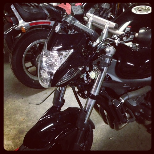

So, it's all done and ready to go. Off the bat I need to thank Cliff (Motogiro) and Borka from BKMoto for helping me along with the wiring questions. I wouldn't have been able to do all of this if it wasn't for this board.

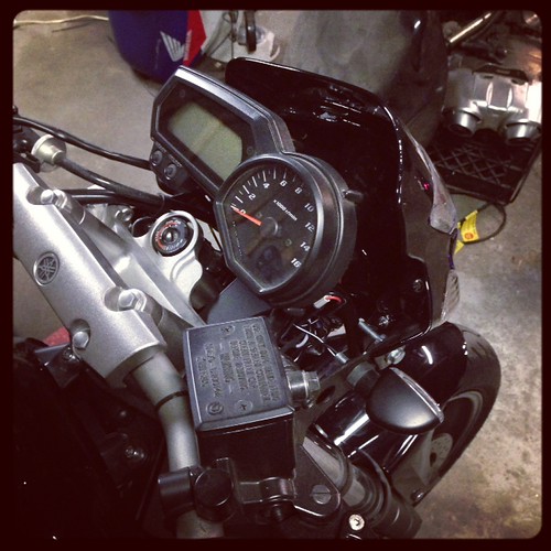

Did this entire conversion keeping the stock wiring harness, adding in the BD43 dual headlight mod (which I had already done prior) and wiring up the HID/Halo and the ballast/inverter with an H4 plug. I was actually able to stuff the ballast and a chunk of the harness under the tank in front of the battery. Was a jenga nightmare, but it all fits!
Here goes:

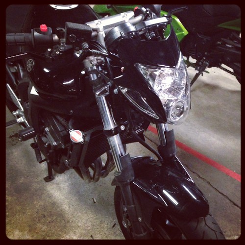

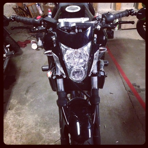

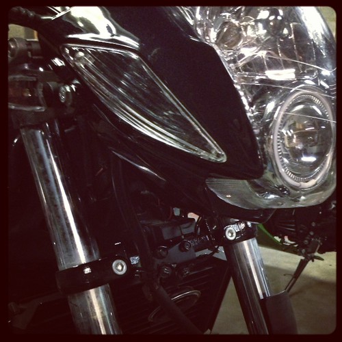

Custom blue halo and HID Bi-Xenon 8000K bulb inside a Honda Sonic style headlamp. Headlight brackets were found on the internet somewhere and modified to accommodate the turn signals and main lamp. Turn signals are from Lockhart Philips. FZ1 bars. Oury grips. Rhinomoto weighted bar ends. CRG knock off bar end mirrors. 2Wheels levers.
Better view with the halo off:

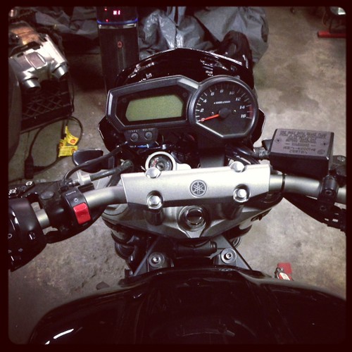

Rider view:
Bought a speedo bracket from Lean69 and modified it a bit for the installation. Added a simple slim 2 prong rocker switch to isolate the halo from the main bulb while riding. So I have halo, halo and low beam, and high beam. Didn't wire in the 25 watt top lamp. I had it wired in for the bright signal but it looked silly (because the HID overpowers it and the color is spectacular), so I scrapped it.

With a lot of patience, I was able to really tuck all of the wiring. Even that giant stock harness/flasher relay/extra H4 socket are all in there neatly.

Looks fantastic! An amazing job! I love the look of the HID!!
Much thanks. I tried to take a few pictures of the halo on with the main lamp, but it was so bright the picture was kinda worthless. I'll definitely have no problem seeing at night. Also, I was very impressed with the spread of light out of the high beam.
