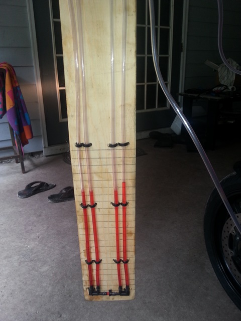

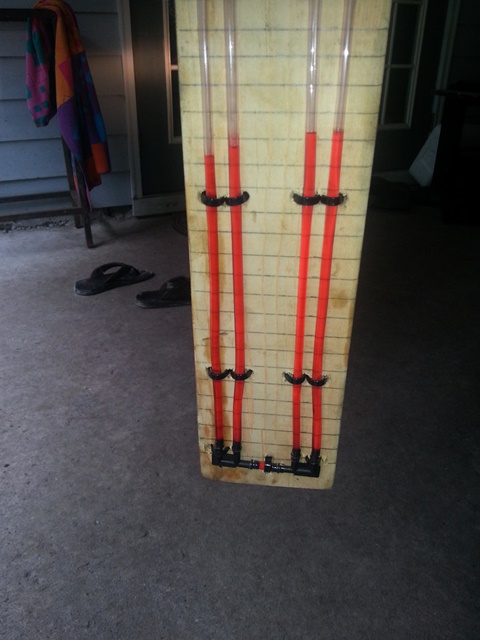

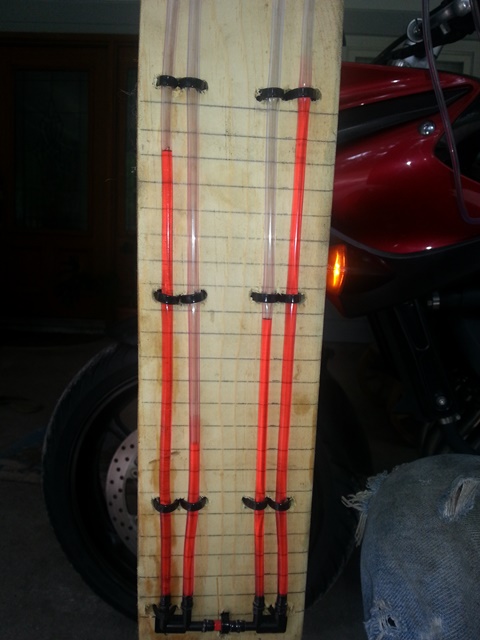

Did the TB Sync on my 06 today. Thanks for all the how-to info here.
Until today I had only done the basic oil, plugs and filters for maintenance.
Here is where it was when I first hooked it up:
This is how it finished up:
And this was at 4k RPMs:
