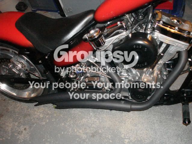

Any updates with painting your headers? i am very much interested in doing this during the off season, my down pipes are a losing battle when it comes to keeping them shiny, plus im more of a matte black finish kind of guy
However, I'll bet that shiny chopper doesn't get anywhere near as much use as say my FZ6, which is used 5-6 days a week in rain and shine, in the city and on the motorway. That's the sort of use that will make the paint chip/fall off, however, adding another layout or two of paint every year isn't a major deal, only cost is a can of spray paint and 4 new gaskets.
