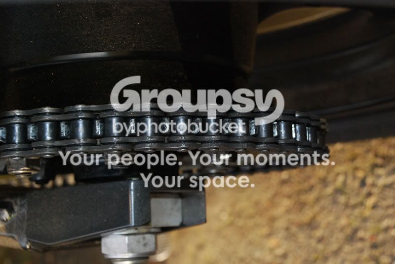

I beleive you are correct to assume that sprocket and wheel alignment *may not* always align. As you may recall I string aligned mine and found it did make both the chain and wheel happy but that may not always be the case.
IME an alinged chain may float to either side but through obseravtion of the contact pattern, you see where the load is. Also keep in mind that any sprocket left out of align would likely wear the leading edge in manor that although the alignment has been corrected it may favor one side over the other.
Wheel & Contact pattern OUT of Alignment:
Wheel & Contact pattern IN Alignment:
FROM ^^ --> How to string align your rear wheel!! http://www.600riders.com/forum/how-to-s-/40463-how-string-align-your-rear-wheel.html
That said, I would try and align it and see what comes of it. Tell tale signs it helped are:
- floats from side to side
- reduced vibrations
- lube contact pattern moves to the center

Was going through my old threads and somehow completely missed this! Thanks FI! Makes sense. My chain wear pattern matches the second picture you posted !:thumbup:
