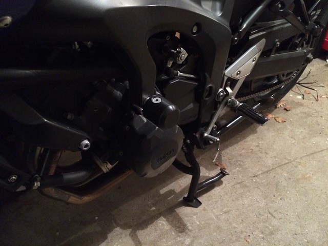

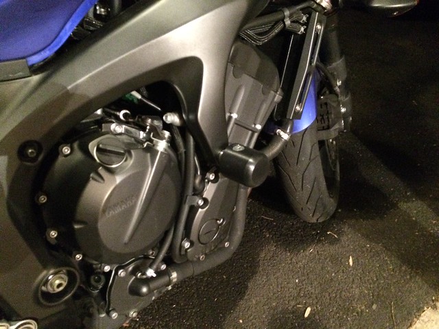

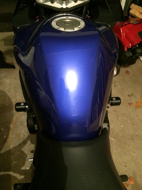

Nope, no cutting needed, they bolt into the same place as the others. Here's some pics.

Added some pics of the woodcrafts. They use a two-part design, an aluminum mount bolts into the frame, and then a flat head screw holds the plastic puck to the aluminum mount from the side. The benefit to this is that you can replace the puck for only $15, and if you do crash, you don't need to dig out a bunch of melted plastic to get to the bolt to get the slider off.
