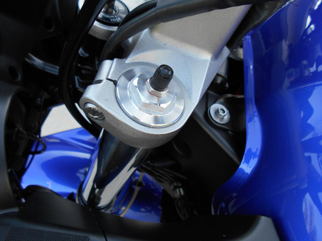

How much air would you recommend Mr Townsend for average street riding with a normal size pilot 175lbs or so?
Tom, I'm about 220lbs and I keep no more than 16 PSI in each leg.
Any higher, I feel every rock in the road.
The 16 PSI gets rid of most (95%) of the stock sag (left the springs in) and firms up the front end a bunch, definitely NOT mushy, no more extensive dive on hard braking anymore either.
If too tight, simply loose a little air.
I use a digital air gauge (accurate to a half pound). I've added maybe 4 lbs every year and a half (twice since I installed them)
