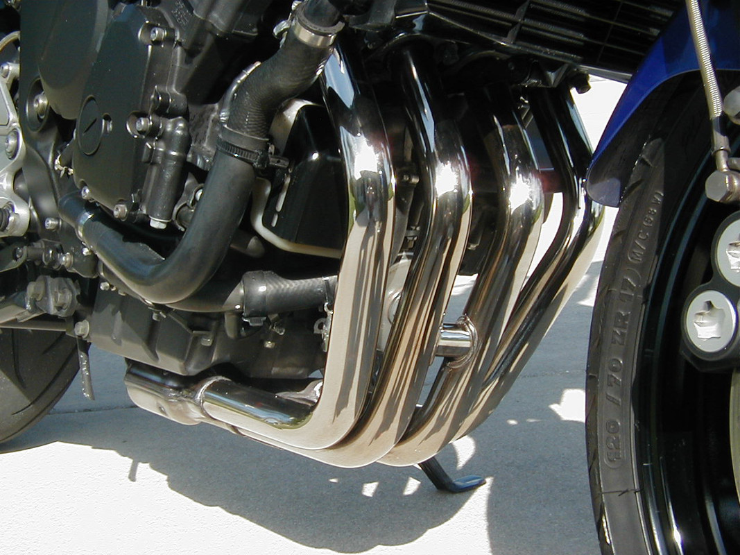

Not really kidding.. Your bike is very sharp, the header isn't :( .
Mothers metal polish. The initial cleaning is a PIA but once cleaned up, maybe every other month
you do a quick clean to remove road crap kicked up:
My header, never removed, cleaned on the bike:
And, I dare say, "but it was well worth it to take the 'Shiniest Header Trophy'" , I prefer the look of the polished stock header. Ceramic is likely easier to keep up, but nothing like polished SS (IMO)..
