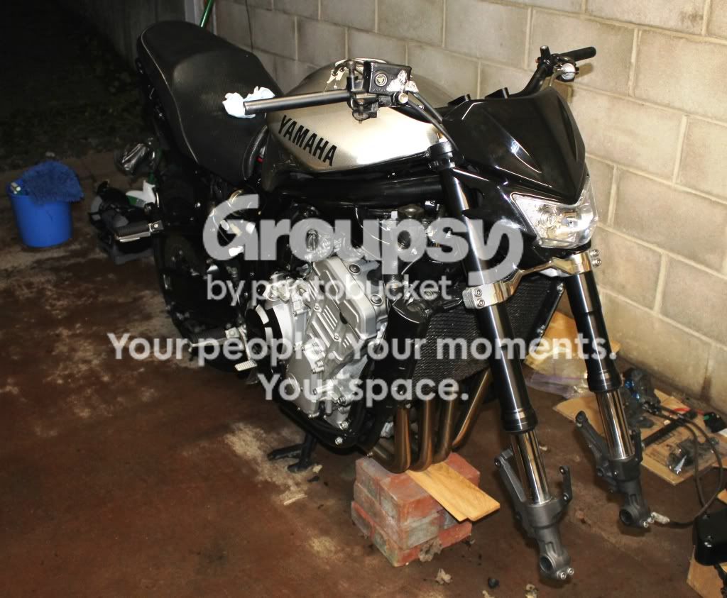

Well...married...moved...and finally have had some time to put toward the project. A quick teaser shot of where I stand; More to follow this week!:thumbup:
My apologies for the photo quality
