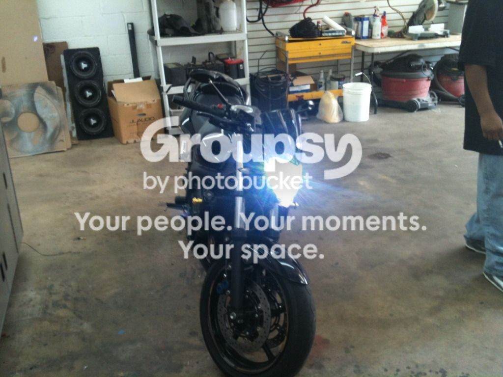

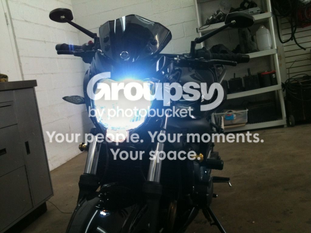

Just installed my HID from DDM Tunning looks amazing will post a pic soon i have the SV2 front end so just the 1 H4 bulb. Problem is the H4 bulb i had the High and Low beam functioned properly but now with the HID in the high beam doesnt work. Any ideas?????? :mad:

The problem with 8000k is, even though there is much greater light volume, you've essentially lost some of the perception of light due to it being in the warmer spectrum.
If you can, chuck some 6000k bulbs in and see the difference!
I've got 55w 6000k in both my cars, and the light output is simply amazing.
I'll be sticking HIDs in my bike first chance I get!

agreeded... the website said the Kelvin rating was a step down. so that the 8000k should be closer to the 6000k, and the 6000k would be closer to the 4000k so thats why i went with the 8000k.
