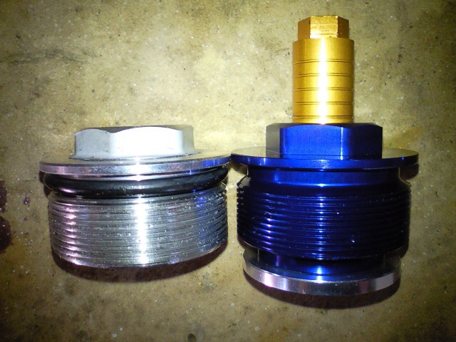

I bought these preload fork caps (cap on the rt) for the stock forks on fleabay. They are made by Slingshot Racing.

Thanks Joe. I was looking at those but I made the decision not to put any significant money into the stock forks, figuring that the REAL upgrade is going to be R6 forks. So I am looking for a real DIY approach.
