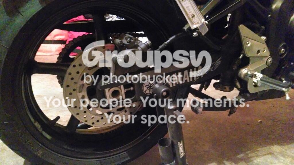

Just added swing arm spools
Marcelor73
Jul 31, 2011
80
MD, USA
I searched around for a while for a way to add swing arm spools. I didn't want the through the axle ones because I wanted to be able to use it to work on the rear wheel. I ended up buying one and then replacing the bolts with longer ones and drilling through the swing arm. Here is a pic.
Marcelor73
Jul 31, 2011
80
MD, USA
But you have a centre stand :confused:
Yes, I know. I want to polish my rear wheel, so the wheel will be off for a while. The bike will be much more stable on the spools than on the center stand without the rear wheel, specially around my 4 year old.
And since I don't use the center stand much, other than in the garage, I might end up removing it.
