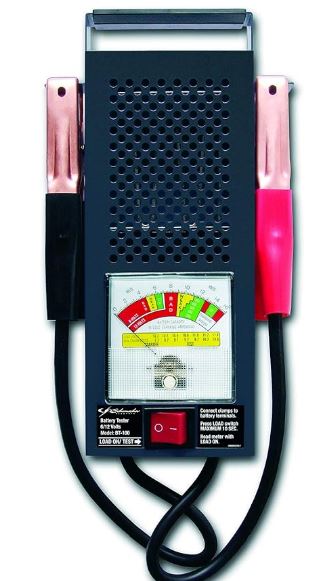

I think most of the testers at auto parts stores are the electronic/computerize type but I like my resistive load tester like Scott's.
I went on the cheap with mine from Harbor Freight.
