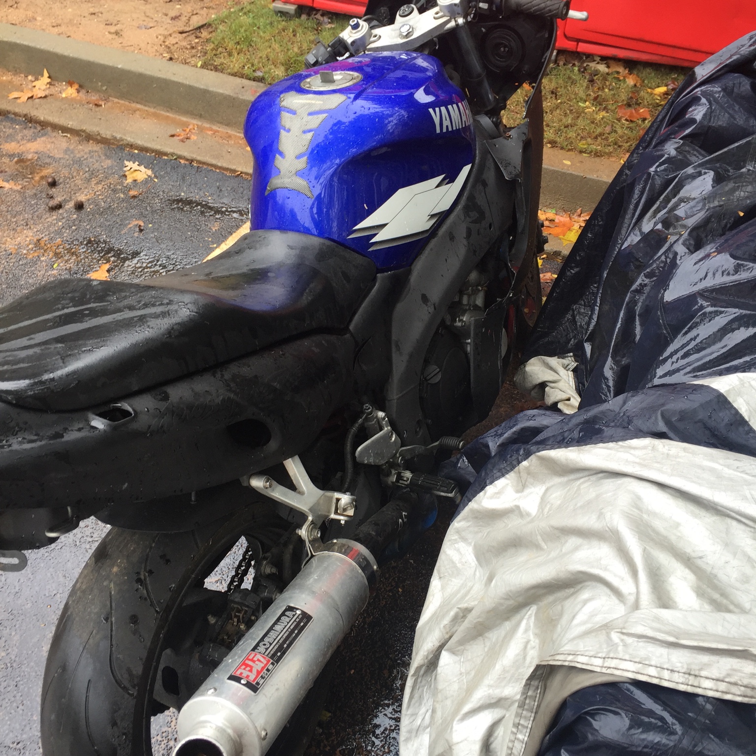

Hey My name is king I'm from Gainesville ga, just got me a Yamaha YZF 600 R Thundercat 98 this weekend for a good price nice little project to work on Im super excited and want to do some mod... But I'm new to motorcycling and don't know anything about fixing them. So need some help and some guidance... Here's a List of things I know it needs done
1.) new fairing
2.) carb news to be clean
3.) new battery
4.) and probably a full maintenance ( has been siting for a while)
5.) and speedometer not staying in place
Will post some pics in the morning if it stops raining

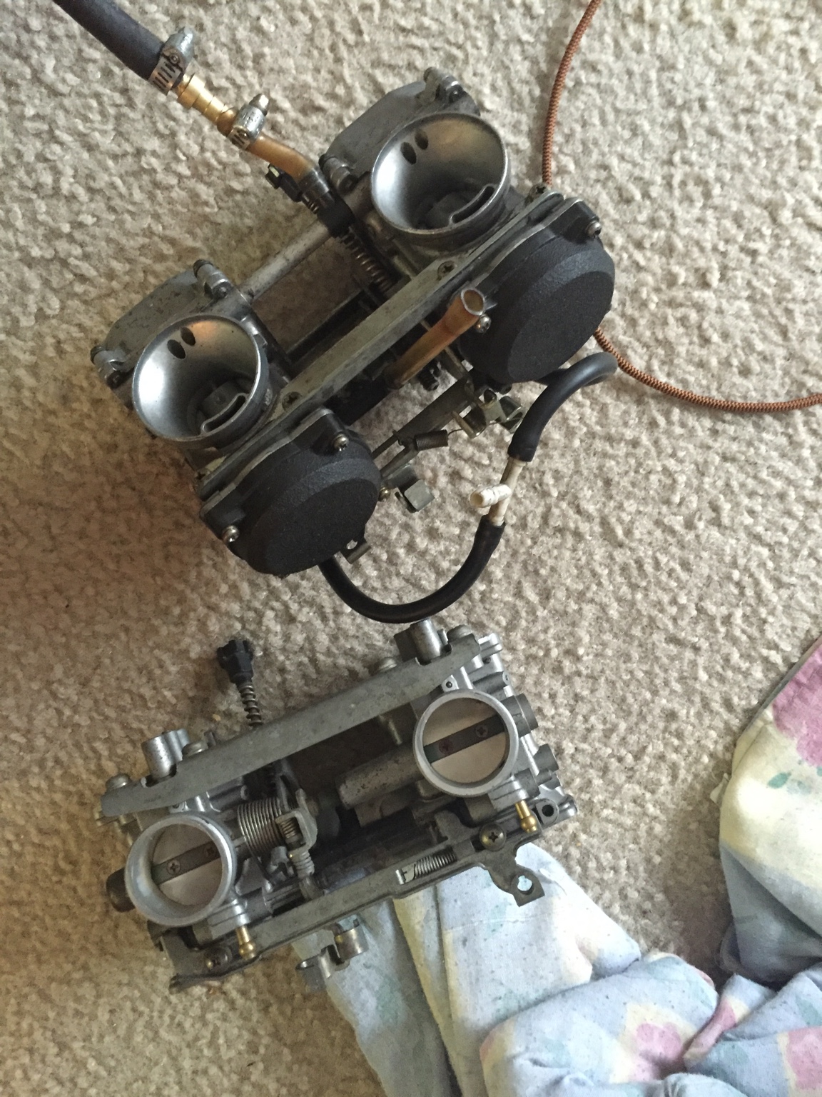

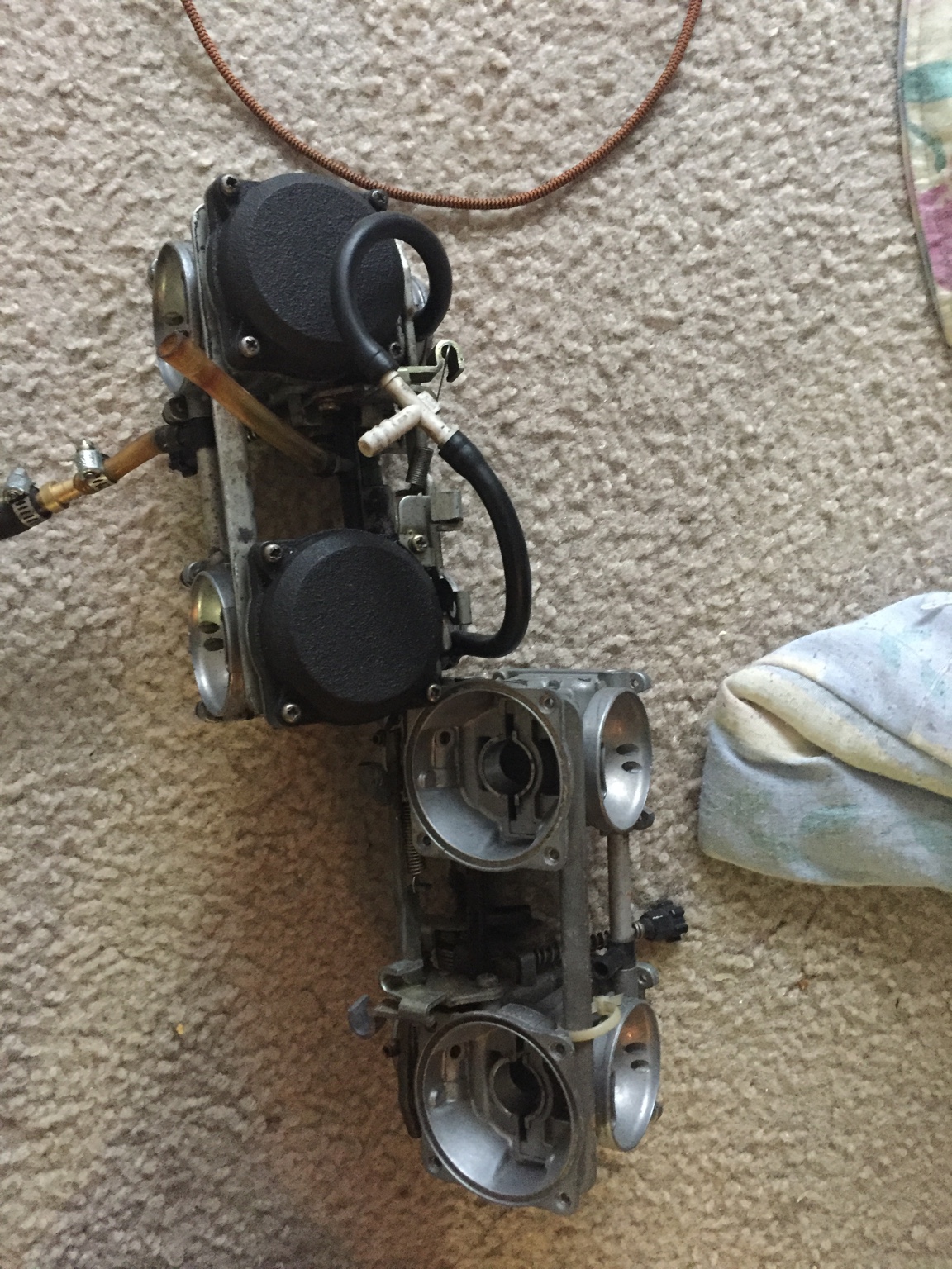

The guy I got it from already toke the carb out and did half and mixed up the parts [emoji31][emoji31][emoji31][emoji31][emoji31] but going shopping this weekend for tools and cleaning stuff to start on this project this weekend

So found out the carb I had wasn't the carb for the bike and that my carb for my bike was still in there lol so next project this weekend is takin that bad boy out and cleaning it

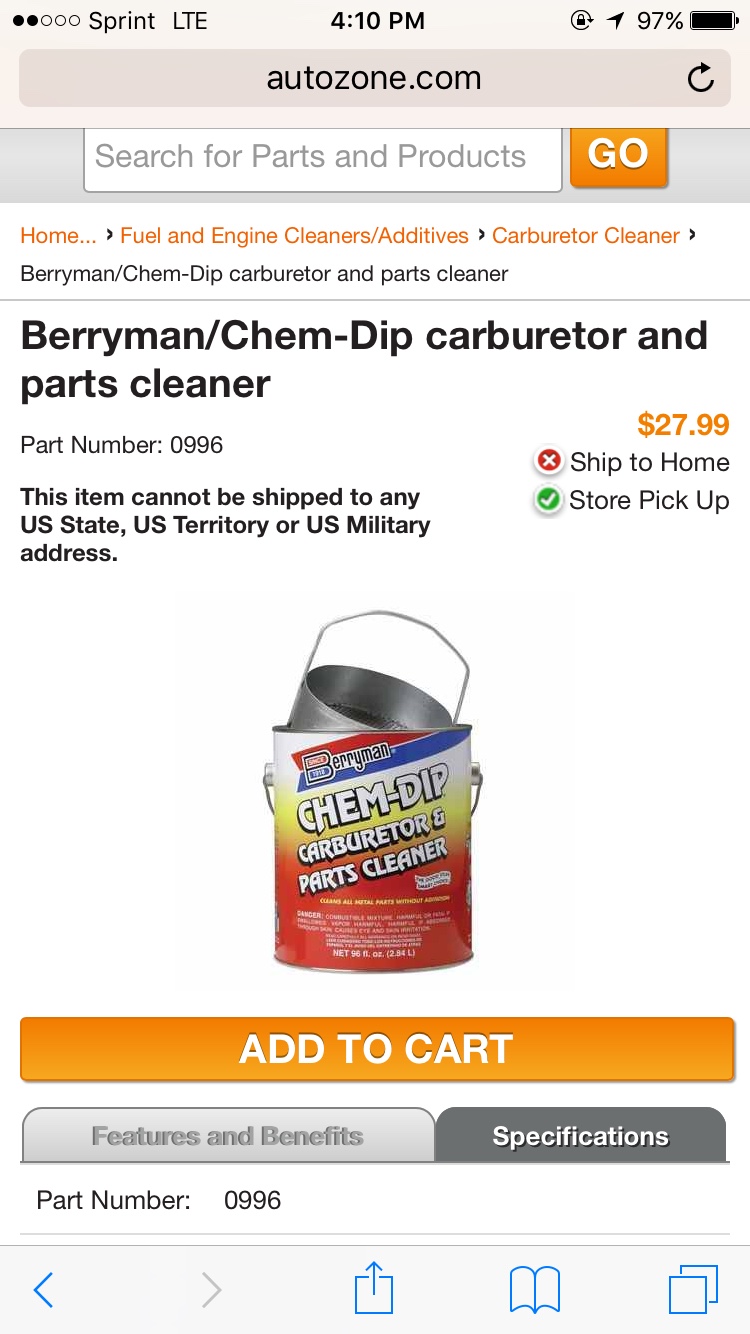

Can I use this to clean the carb and just burst off any extra left over ?
You can use it for cleaning however its IMPERATIVE to remove ALL THE JETS, IDLE and MAIN. Those are what usually clog up. Its rare I even pull the slides, etc as the bowls / jets clog up with varnish, especially if left with OLD, untreated fuel. Blowing the orifices is good too. I use brake cleaner around rubber parts.
Varnished up, METAL PARTS/JETS, I use carb cleaner as its much more aggressive. A moot point if your using a dip...
If you CANNOT see thru EACH JET, it ISN'T CLEAN...
And, often over looked. Inspect the fuel tank, flush as necessary until it's spotless.
Also remove the on/off FUEL valve, clean, check, etc. It usually runs off (opens, allows flow) of vacuum

I had a thundercat before this motorcycle. Was a good motorcycle. You should join the forum mentioned earlier, lots of 600r knowledge on there. I still check it out every once in a while. My carbs looked different than the ones you posted a few posts back, and I never seperated them like that, I kept all 4 together. I got to where I could get those things out in about 10 minutes.
Youre going to want to do a carb sync once you get everything back together, and make sure to check the float levels. One thing to check when you get the carbs apart are the orings on the fuel shotuff valve in the bowl. One of those cracks or gets ****ty and you'll get a nice flow of fuel out the overflow. Another thing, I replaced the fuel hose from the tank to the pump with one that was about 2 feet long so i could sit the tank to the side and still have fuel for carb syncs and stuff. Also helps with the float check. You dont measure like a regular carb, you let the carbs fill up, attach a tube and theres a mark on the side of the float bowl. The fuel should be 7mm below it. (thats from memory, check the forum or service manual to be sure).
