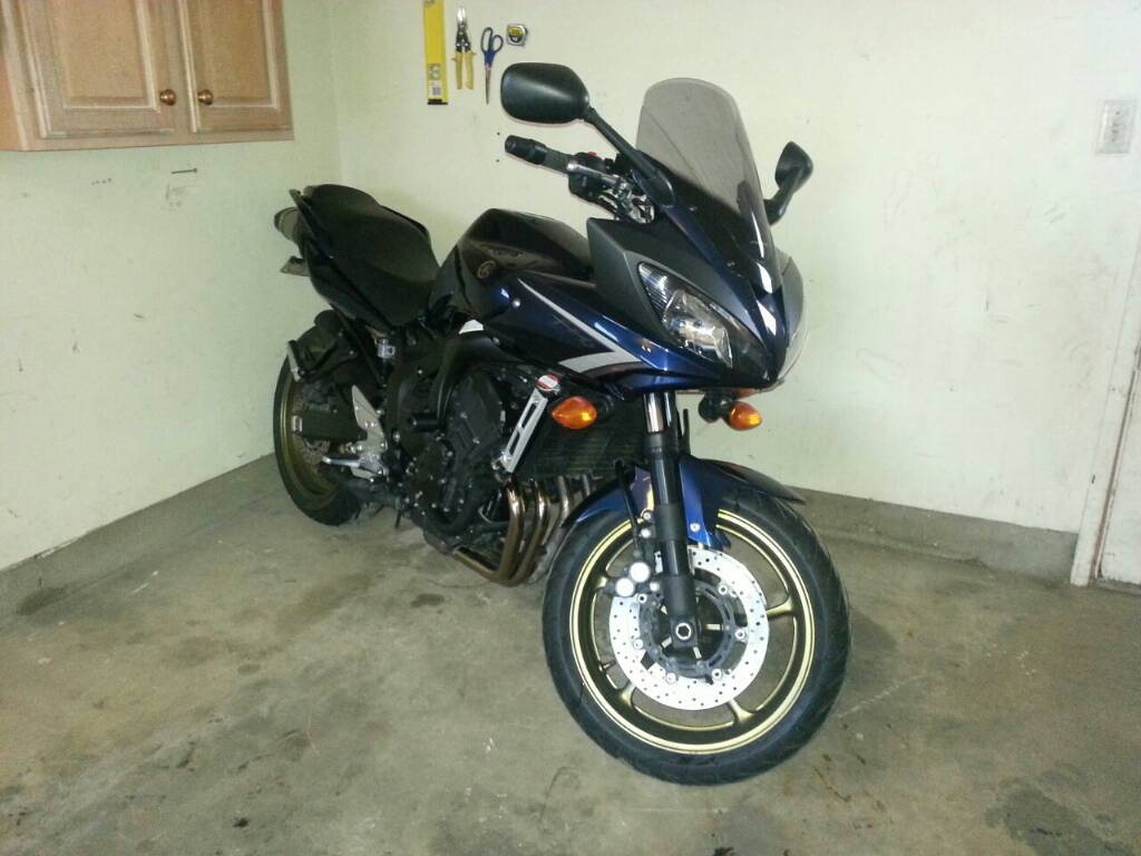

Well I had posted up pictures of my bike previously and someone mentioned my headers. It was probably one of the last things on my mind to do until I looked at them.

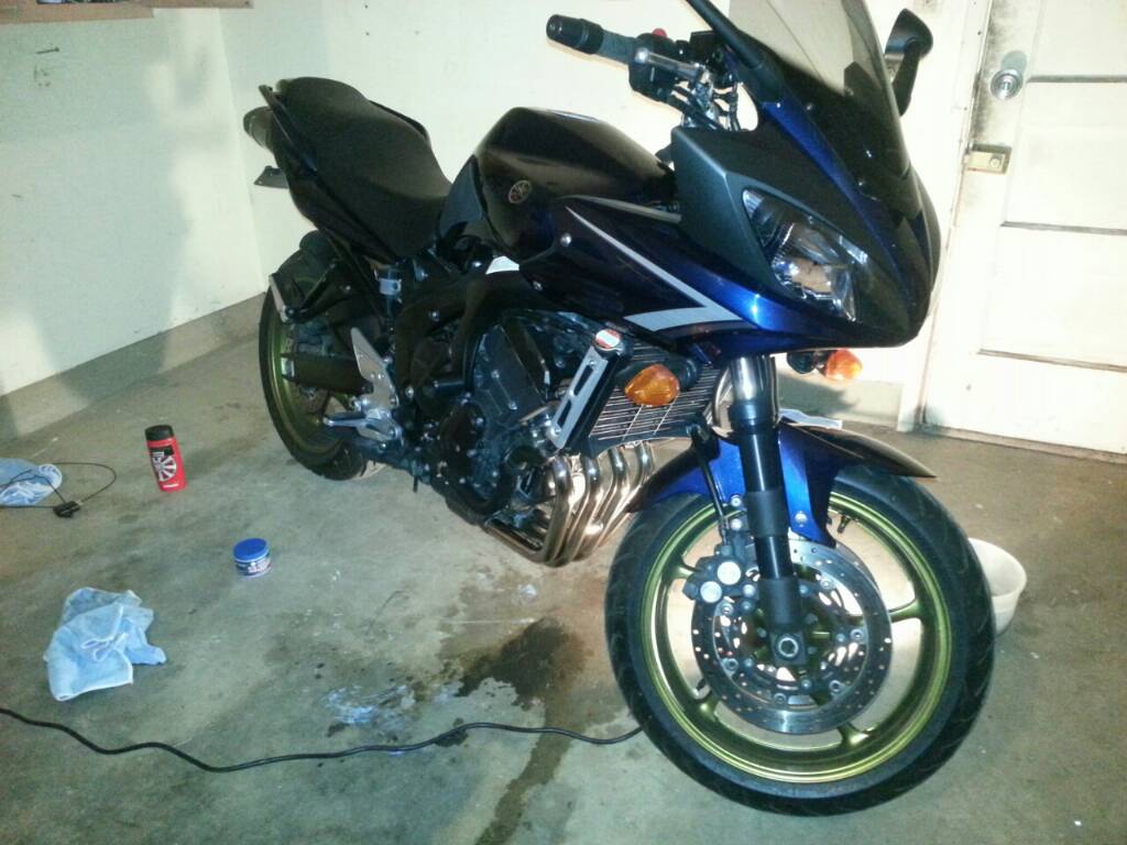

It took roughly 4 hours to do the pipes, but some of that was because I ran out of elbow grease a few times.
Before:
During:

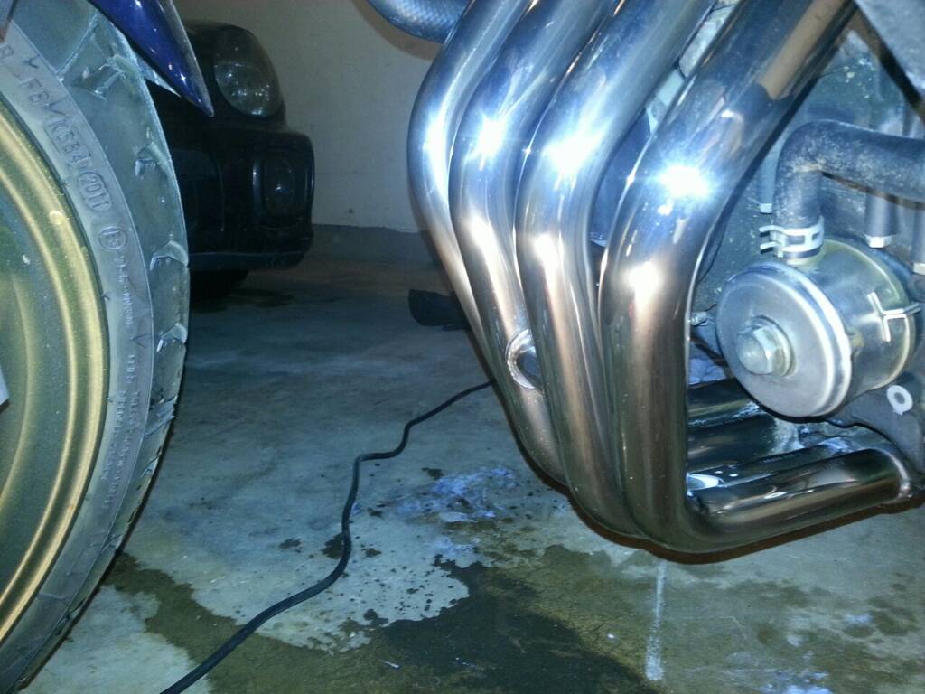

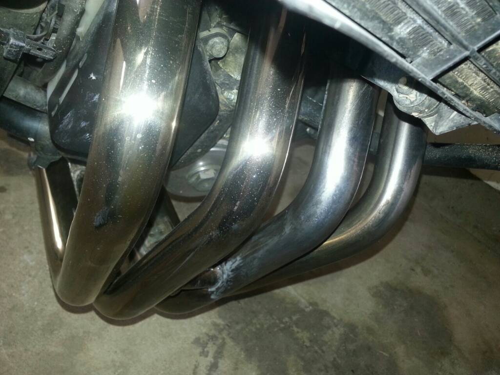

And after:
I started with some Meguiars metal polish, which seemed to be taking forever so I moved onto using Blue Magic. It may of may not actually work better since they had been partially polished from the Meguiars, but it felt like it took less effort.

Thanks! It's a lot of effort, but well worth the reward. When it isn't snowing I'll get some better pictures. I already cleaned up those radiator hoses too and plan to wax the bike shortly.

One thing I forgot to mention, I also used "fine" steel wool as well. I rubbed in some of the polish on and then basically sanded with the steel wool. This seemed to help provide a better end result.
