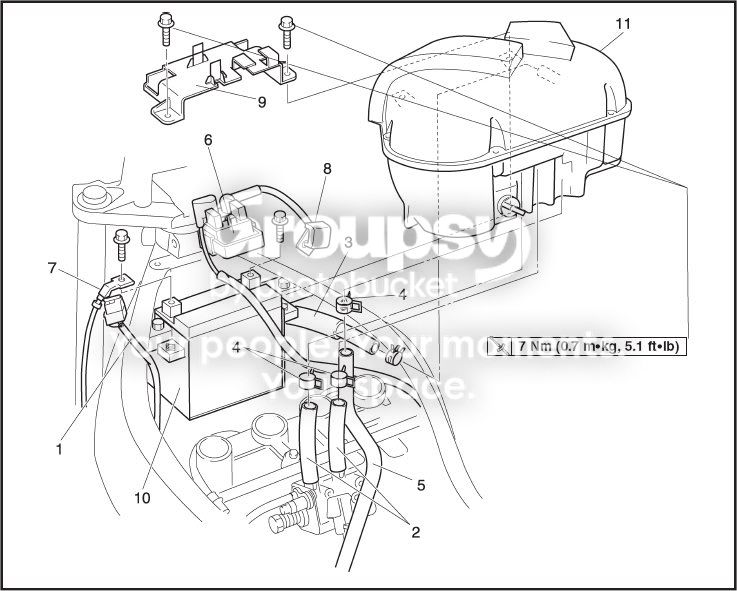

I'm planning on hooking up a power outlet and battery leads to my 2006 tomorrow and I have two questions:
1: In order to access the battery to wire up the fuse block and battery leads I assume that I need to lift the tank, but not the air box. The diagram below leads me to these conclusions. Is this correct? I've never lifted the tank on this bike and I'm curious what I'll be getting into to.

For number one, absolutely yes. I just added a heat controller that connects directly to the battery. Just lift the tank, prop it up, and add in the leads. You may have to remove the 2 small side fairings to lift the tank -- on my 2008, I did.
Also, as soon as you unscrew the battery lead, the square metal it screws into may fall down. I used a curved bread tie to hold it up to get the screw back in. It was annoying but have done this several times before so no worries.

Actually, the easier way to lift the tank is to temporarily remove the bolt at the rear of the tank, slide the tak backward, raise the front of the tank, and then slide the bolt back in. That avoids having to mess with removing the inner fairings to raise the tank.

2 ways to get the tank out of the way:
1) remove the inner fairing pieces, the allen bolts at the front of the tank, and tilt it up out of the way.... I use the end of the handlbars for the prop. Turn the steering full lock, and it will support the tank.
2) Take the seat off, remove the bolt through the back mount for the tank, then pull the front two allen bolts.... then slide the tank backwards to clear the 'pods'.

-I already planned on using the method that doesn't require removing fairing bits to lift the tank (ie: pulling the rear hinge bolt etc...)
-I'm glad I don't have to remove the air box. That seems to cause some people no end of trouble.
