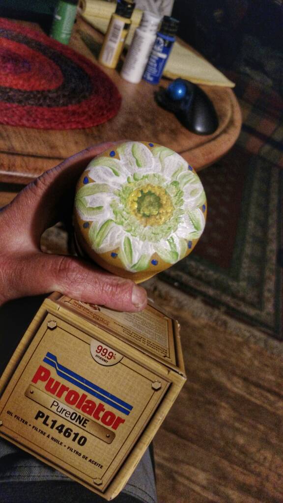

He crossed the Purolator # PL14610 to a WIX #51356 for $7.99. It was a tiny bit smaller in diameter than the OEM Yamaha filter I removed, but had a much larger o-ring seal. So I did the oil change (you guys are right... messy! No good place to put a catch pan.) and put the filter on. Added 3 quarts and test rode around the block, no leaks, no issues.

Well, It can be difficult to remove the old filter because you can't get a grip on it because it's up against the engine case. The best tool to remove old filters on the FZ6 is one of those filter sockets you use a 3/8" drive to turn.
Just make sure you get the small size and be sure it fits your filters before you buy one. Makes filter removal a 10 second job.

If you get the long version of the Purolator filter, I hand tighten mine and never had an issue leaking. I use an oil filter wrench to take it off and usually gets all smashed and torn to pieces but who cares at that point, it's getting replaced.
