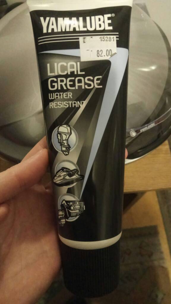

Plan on doing some maintenance tomorrow, would this grease be ok for lubing the rear axle shaft?
The manual says use lithium based, but I don't have any at the moment

I've used waterproof marine grease and never had an issue with it. Did that tube seriously cost $82?
Yep, it has golden flakes in it for extra luxury :D
But seriously, I'm in Europe, Croatia - converted to USD it's actually 12.50 [emoji106]
oh hahaaa ok.. my bad. I should have realized. I would use this lube without any worry. if tough enough for marine use it should be fine

Plus 1, it'd be fine.
That's a very old tube but for the axle is fine.
Yamaha make a water PROOF grease used on the lower unit drive shaft, prop splines, etc, that way outlasts anything else exposed to water/ salt water (and not much more $ surprisingly.)..
