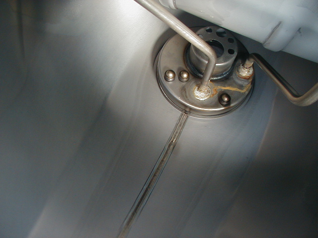

There are different methods for removing rust from the inside of the tank. Looks like you got most of it cept for the top.
Electrolysis works very well as well as chemical agents. I would try to get the rest out just so your not doing "a do over" later down the road.
The inside of my old tank before I sold it (minor scratch on the outside):
