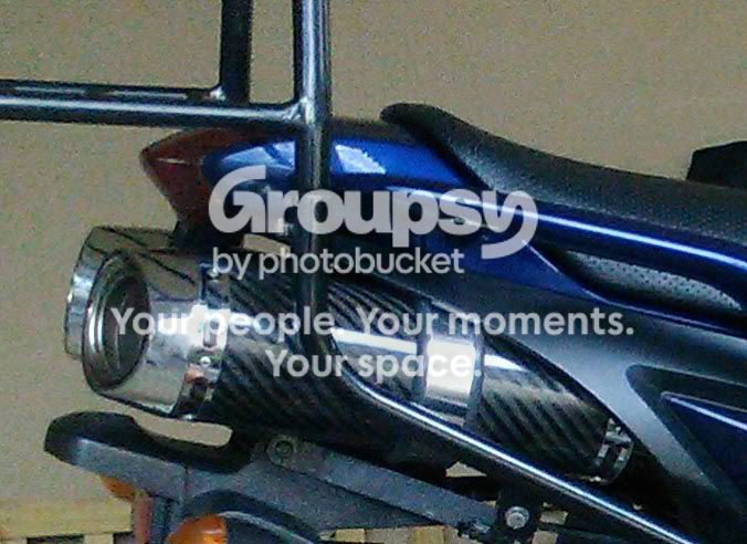

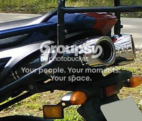

Well they're on guys!
They are the exact model and finish as in Scot's earlier thumnails. Stainless tri-lobes.
They sound freakin AWESOME!:rockon: I've been out lookin for bridges to ride under!:spank:
I left the db killers out and hit the rush hour - for about 2 hrs.:Flip:
I seemed to have a new level of confidence in heavy traffic too, just grabbing a handful and going for gaps.
They look great too, but I now have one big headache of a problem......:(
My Givi top box rack fittings wont re-attach or even quite fit around the cans.
Going to need to make some serious mods to get it right.
Anyone had similar woes? I really need the box and pannier racks all the time.

Glad to hear you got them on, sound great don't they? I'm not sure how the racks mount, perhaps a couple of pic's posting where they interfere with each other may help with a fix (if someones already dealt with it please disregard). Is it possible to rotate the mufflers some to gain the clearance you need? I know the actual clamp around (with inner rubber) has some play...
Its been awhile since I put my cans on but I don't remember any issues with the plastic at the rear of the bike filling in the gap inbetween the pipes. If you have the stock fender, it looks like that center piece does help hold up the rear fender.
If the lower fender is gone (fender eliminator) you can either trim it neatly with a small Dremel rotary tool OR, so you don't have a gap there, make up a small bracket out of thin aluminum, attach it to the lower part of it, then to the Scorpion mounting plate (or other solid object)...

Scott, I see what you did by rotating the cans. Yes they are offset so in the position you have them they do not spread so much. I have had to do the same.
I found the problem with the Givi rack arms and fittings is that the original plastic shroud tapers towards the rear of the bike so all fittings are shaped and welded to suit.
Having ridden around for a day without the rack, happy as a hooker who's just won the lottery, I decided to strip it down and start over, this time with an eye on making all the bits fit.
I can tell you it took some bullying and bending of brackets but I just about managed with the cans rotated as suggested. I take 'The Pillion' out quite a bit and she likes the box in place so she can relax against it. More for security for her and very practical for me as I travel always with a lock/chain and my 'wets' and spare gloves. You know how you cram all sorts into a cage's glove box? Well my top box does that for the bike.
