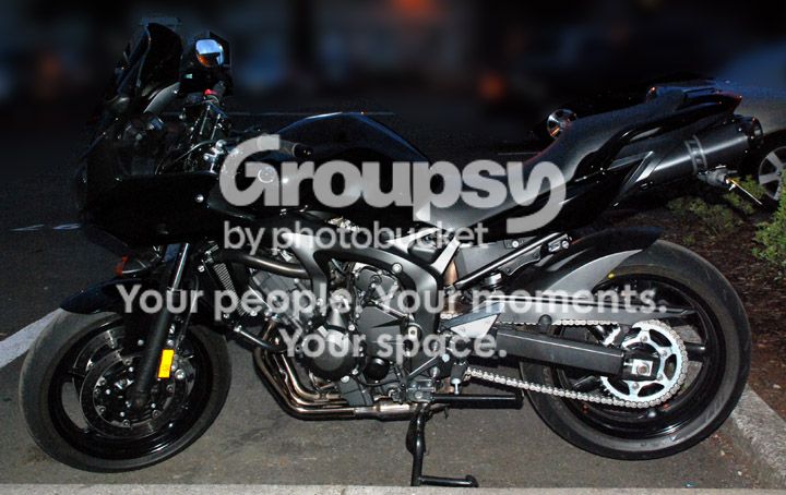

2013-06-12 Time for an update!
The ONE thing I never thought I'd spend money on came last night (Hint: rulez were broken), and now Crisis is all torn apart!
I shall join the loud and obnoxious gang blowing smoke through this!
The ultimate in crappy photos....
Crisis is Ready to Rock and Roll! Pipe install was painless. Undoing and redoing my lights, that was painful. I see changes in her future with a complete custom tail tidy and real mounts for the pipes. The current TT shakes a tad. I'm not liking that. Sound is pretty Awsome! We'll see how long until I get evicted! lol
She is now keeping the spirit of NorCal FZ6, bike alive with Two Brothers Exhaust! Thanks Man! Loctite was applied to most fasteners and on the pipes went!
Thats it for now! Maybe some day time photos later! :thumbup:
On a separate note:
Old Fizzer exhaust OFF! New Two Brothers Exhaust ON (w/DB killers installed)! Battery was never disconnected so that is what I'm talking to.
The weather here is cool and wet, Below 55F. Her normal temps would be 165 for the ride I just did. It is my butt meter that says, this has leaned the engine out a tad as the performance is down and the temps are UP 177, but not enough to ping or detonate.
It MUST be breathing better!!! :thumbup:
Yes, it has the DB killers installed and whats funny is open CAT is just about the same idle volume as TB with DB killers installed! :spank: :spank:
Just thought I'd share!

On a separate note:
Oh ya reset the battery. A TB sync couldn't hurt. Cool beans! Bike looks great!
The extra Fiberglass packing I believe is for one piping you'll need rivets when repacking. Be sure to request the "updated rivets" Two Brothers utilizes when or if you repack mufflers. I mean rivets are rivets, but if Two Brothers are claiming they use different ones than what they include in the repack kit. Perhaps you should request them. They did engineer the exhaust... Just sayin. Shouldn't have the need to do for awhile. Its totally doable with the DBs. But if you get a chance take that puppy out this summer and remove the DB killers. You'll know what I mean when you have a big ass smile on your face:thumbup:
I always wondered what it would be like to change to a better cooling fan with this bike compiled with exhaust and bypass computer.
