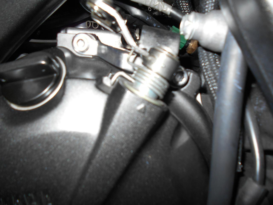

So my bike stalls when you put it in gear, it jumps forward like the clutch isn't fly engaged, I've tried to adjust the handlebar lever but it makes no difference, also tried pushing the lever on the engine in and it's still the same, now as I've never ride the bike I don't know it's the clutch, so removed the plates and reassembled but still the same, took some photos so if I could have opinions on of it looks normal that'd be great

My first thought was “frozen clutch plates” but the disassembly and reassembly would have addressed that. Perhaps is “was” frozen plates, but now it’s how it was reassembled. Are you sure the actuation lever was properly reassembled?
That's the thing, like a damn fool I didn't mark it's position before I removed it 🙄

**With the oil fill cover off, you can see the top of the clutch.
When you pull the clutch lever, you should see the
clutch separate, clutches pulled to the outside / right side of the engine, do you?
**Also, there IS a dimple on the engine cover AND the clutch (at the engine) lever.
When properly on the correct spline, adjusted correctly, ONLY THEN WILL the marks line up

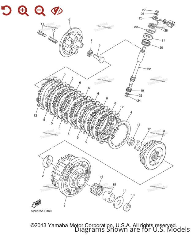

Pressure plate move 3-4mm and still doesn't disengage
Part #3 is connected to the transmission, part #1, is run off the crankshaft. The clutch connects the two.
From what you describe, if the clutch plates are separating, it sounds like you have an internal, transmission problem.
With access to the clutch, plates removed, Part #3 SHOULD spin freely when in neutral.
When shifted into gear, the Output sprocket SHOULD TURN.
Check for turning in first gear (likely won't from what your describing) and other gears...
And you shouldn't have any noticeable brake drag. If you do, brake calipers need attention...
With the plates removed Number 3 does turn freely in neutral, when in gear it turns the rear wheel

Since this is a junkyard bike, it's very possible that the clutch plates are not correct, have too many plates...who knows. It is worth your time to base line everything in the clutch pack. Have you taken the time to place each plate on a flat surface to ensure that they aren't any warped, and that each plate meets spec? It doesn't take much to lock-up a clutch.
Ok, that's very good, trans sounds good.
Something is binding up, as Gary points out, could be clutch parts, missing collar, etc.
I'd check the parts diagram very closely AND check spec's on clutch plate thickness, etc
