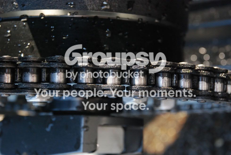

One day i noticed the grease wearing off my rear sprocket on one side of the rollers only. This was like a hint that the wheel may not be aligned perfect. From this, I did the string align and that knocked down some speed related vibes.
>>CLICK PIC>>
WORK THAT REDUCED VIBES:
- plug wires (reduced vibes across all RPMs)
- rear wheel alignment for drive chain (road speed vibe reduction)
- Chain maintenance - Clean, Clean, CLEAN and lots of Lube 400 miles max interval
- draining Mobile One oil (2000 miles or less) I couldn't take the vibes!! I know millions will say I'm full of BS, but I'm saying I ROUTINELY CHANGE ONE THING AT A TIME and I CHANGED THE OIL AND THE VIBES WERE REDUCED! Hey I'm not the only one that dumped that bike specific expensive product throwing away money to know if that was it. It was!
