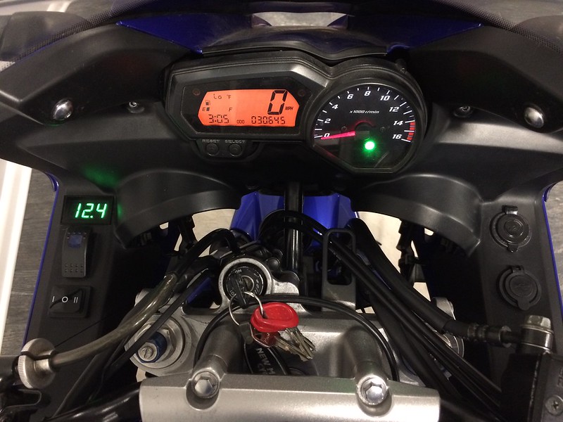

I have a 12v cigarette lighter outlet and a USB outlet on the right inner fairing panel. Hooked up via a relay, along with heated grips and a voltmeter on the same circuit.
(The inner fairing is for sale, $3000, comes with the rest of the bike!)
Rydonair Universal Rocker Style 4.2A Dual USB Charger Socket with Blue LED Digital Voltmeter for rocker Switch Panel on Marine, Boat, Car, Golf Cart, UTV, ATV, etc
https://www.amazon.com/Rydonair-Universal-Charger-Digital-Voltmeter/dp/B076MSVQ9S/
$16

How accurate would that be, from the battery, to a digital battery gauge on the dash?
.1, .2 volts drop from actual battery voltage?
I'd like a switched, EASY, ACCURATE, digital, voltage gauge recessed into the inner fairing..
