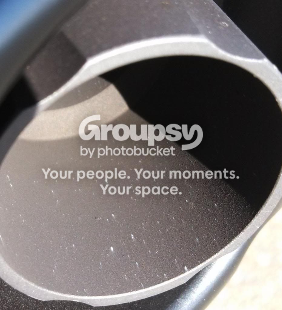

WTF is that in my exhaust???? Could it be Piston?
The system WAS Ceramic coated inside??? There was no mention earlier of this.... :confused:

I had no idea the inside of the cans or y was coated. I did fasten the end caps with light duty Loctite but I can't imagine that migrated out.
Also to clarify; I had a poor choice of words in OP. It obviously is not "vapor" we see there, but when touched it disintegrates leaving a smear of ash you can blow off. Lastly; per Manx instructions the mid pipe is joined w/ silicone.

Thats funny! Carbon burning thru???? My cans really dont get hot.

No. I think youre mistaken. There was mention of the pipes being ceramic coated inside and out. Just perhaps not in this thread. And yes I used a Power Commander.

Yes, going back, there was mention in this thread re Ceramic coating and used/sold pipes. I'm not aware one way or the other if the ceramic coating would put out those small particles in either case..
Pulled the plugs, nothing going on there - the cause was likely me disturbing something during tail pipe removal/tail pipe / can install.

For about 400 miles this never repeated itself again. Then on a recent run it covered it white with at least twice the density! I still have no idea what might be causing it. :rolleyes:
