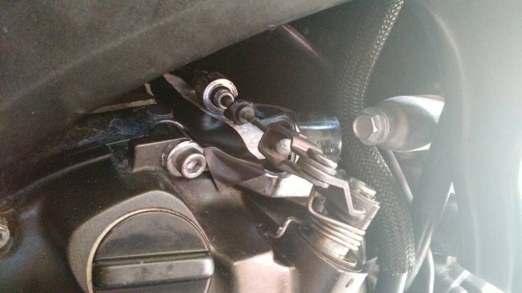

Hi guys,
I'm hoping someone could give me a little guidance on a issue I'm having. Lately the feel on my clutch has been very resistant. By that I mean taking a lot of force to pull. I released the clutch cable on both ends and pulled it both ways through and back again. It's pretty fluid; the cable has less than 5,000 miles on it. This lead me to notice a bit of resistance in the axle pull lever on the clutch itself. When the lever is pulled inward towards the bike everything is fine, but when it is pushed and goes back the other way it gets hung up for just a second. It's like a little click and resistance as it passes. Could this be contributing to the rough clutch pull? Or is it the clutch itself? It doesn't make sense to me because it only catches on release. My clutch lever is well oiled, the cable is fine, what else could it be?
Here is a video of what I am talking about. Does anyone else have this little 'catch' or is it just me?

Not sure if you know it or not but the main spring there isn't installed correct.
It should be set to pull the arm outwards(pulling the clutch lever at the bars back to rest). (If you need a pic, I can shoot one and post it).

As for the sticky "arm" return in your video, its somewhat a moot point as the mechanism doesn't start to pull the clutch apart (dis-engage), until all the slack is taken up. Your checking the lever in a spot its not even used.
In the parts fisch below, the main shaft, part #22 rotates(which is what your doing) and pulls on part #8 which disengages the clutch.

I moved the spring out of the way to better access the arm. [emoji12] Thanks for pointing that out and offering to show a pic though. I have never lubed my throttle/clutch cables for lack of tools and understanding of the importance of it. Haha [emoji51] I now know.... I just ordered lube and the tool to make it happen. Hopefully that's the problem.
Have you noticed the click in the clutch arm on your bike? Or is it just mine? I'm just curious if it's a problem with the clutch or that entire arm assembly. But I mean like you said I guess it doesn't matter.

I figured you just had it out that far but wanted to make sure about the spring.
I've never had that arm twisted that far out (no need to) when I've pulled out the clutch cable.

Can I ask you something else? How in the world do you release the cable at the lever without releasing the arm? I understand that you turn the barrel adjuster all the in to make the cable as loose as possible. But there is no chance of mine being removed at the lever with the arm still attached. There is just too much tension. I'm worried the little metal tab on the arm is eventually going to wear out and snap like a paperclip bent back and forth. But I just don't see anyway around it.
That spring is on there correct.
Re releasing the cable. Obviously turn in the adjuster all the way. I can usually still pull the lever with the sheath up against the adjuster and it'll give me enough to release it.
If not, Much easier, but slightly involved, simply remove the clutch perch to lever bolt and nut. The clutch lever is now loose COMPLETELY from the perch. Pull it out, turn it slightly and you now have access to the end of the cable, barrel end, etc for lubrication etc..... A lil grease on all the moving parts at the lever when re-assembly wouldn't hurt..
You should't have to mess with the lower end of the cable at all just for lubing.
Should you for some reason, there's a very thin steel retainer where the LOWER cable hooks up with arm (you've been playing with). Bend that out slightly and the lower end of the cable will come out.
**MAKE SURE THE LOWER END OF THE CABLE (the inside part of the cable) IS SEATED FULLY in that lower, engine arm.

Makes sense. Not sure mine is capable though for some reason. There is zero slack on my cable to remove it from the lever. Will try what you're talking about when I get my cable lube and release the cable again though. Thanks much.
12,532
1,178
Makes sense. Not sure mine is capable though for some reason. There is zero slack on my cable to remove it from the lever..
Two things, was it like that before???
And if it WAS NOT, make sure the engine end of the cable is FULLY SEATED. If the cable end is NOT fully seated, it'll do that (which it likely is).
* *You didn't pull that main shaft (with the lever) up at all did you OR re-clock the arm on that main vertical shaft??
This is a pic of my lower lever (adjusted). Please notice the two dots on the clutch cover and the lever arm, they should be lined up-again, everything's adjusted (un-less you have the Killer noodle mod which you don't appear to have).
Sounds like the mid adjuster is over-extended and needs shortened. Lift the tank to access it. In the picture below this is the OEM cable from 2008 w/25,000 miles and no issues. I lube it about 3X year just as it starts to get bit crunchy!
FWIW: If I screw the thumb wheel in completely, I can pull back on the 90° elbow (at cable perch) and release the cable from the perch w/out having to do anything else. With the cable free from the perch, move it to align with the levers opening and it pulls free. Once free, I insert a small teflon tube and force engine oil past the elbow. It doesn't take much. Once you start riding the heat and vibes allow the oil to migrate down the cable and it frees up getting smooth again.

Please watch this video: [video]https://www.dropbox.com/s/uzzkeu643dettfn/XiaoYing_Video_1443225822483.mp4?dl=0[/video]
Yes the arm is all adjusted correctly still I believe. I didn't pull up on the shaft or anything like that. Everything looks like the picture you posted. The end of the cable sheath is seated correctly as you'll see on the video.
PS - no comparing the throttle cables to the clutch. The load is nothing compared to the clutch cable.
That's a good idea, I had forgotten about the adjuster half way through the cable. Tomorrow i'm going to remove the tank and airbox and check that adjustment whilst lubing it. I will report back to see and let you guys know what's up! :Flash:

A video is worth a thousand words......
Yep, someone adjusted the mid-adjuster way too tight.
Just to add to FI's above post, TIGHTEN (loosens the cable) enough that you NEED ABOUT 3-3.5 turns of adjustment OUT at the upper lever adjuster once adjusted correctly.
After that's set, you can easily remove the cable from the clutch perch easily for maintenance and still be able to make fine adjustments.
(BTW, what I referred to earlier was to remove the LEVER ITSELF((ONE BOLT)) from the perch, NOT the entire perch, but your so so far out or adjustment, you have to adjust that mid adjuster...
