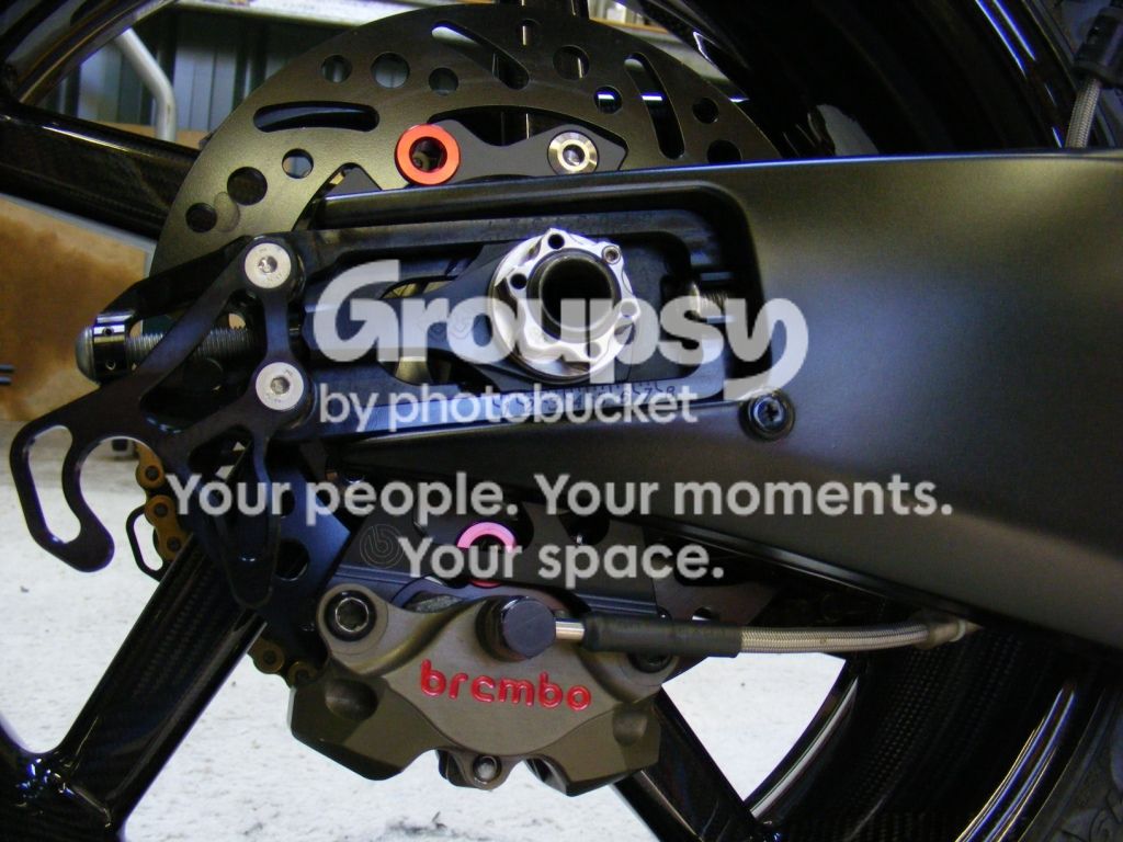

S2 swingarm bolts on, and has adjusters like your R1... I think you guys can even get them with a silver frame?

The S2 swing arm does offer one benefit in that you can use a set of dial indicators to measure from the end cap to that aluminum block.

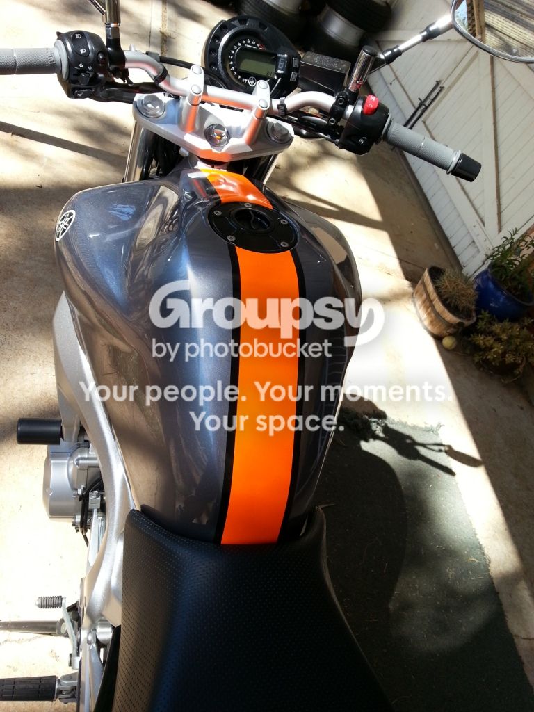

How did you do the orange stripe on the tank? I want to do something like this on my bike.
I got some orange signwriting vinyl, cut some 65mm strips and stuck them on. And I put some 9mm black pinstriping tape on each side. It looks way cool I reckon.
