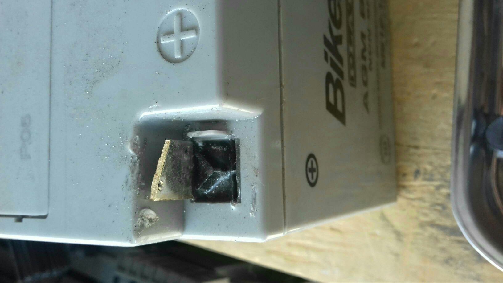

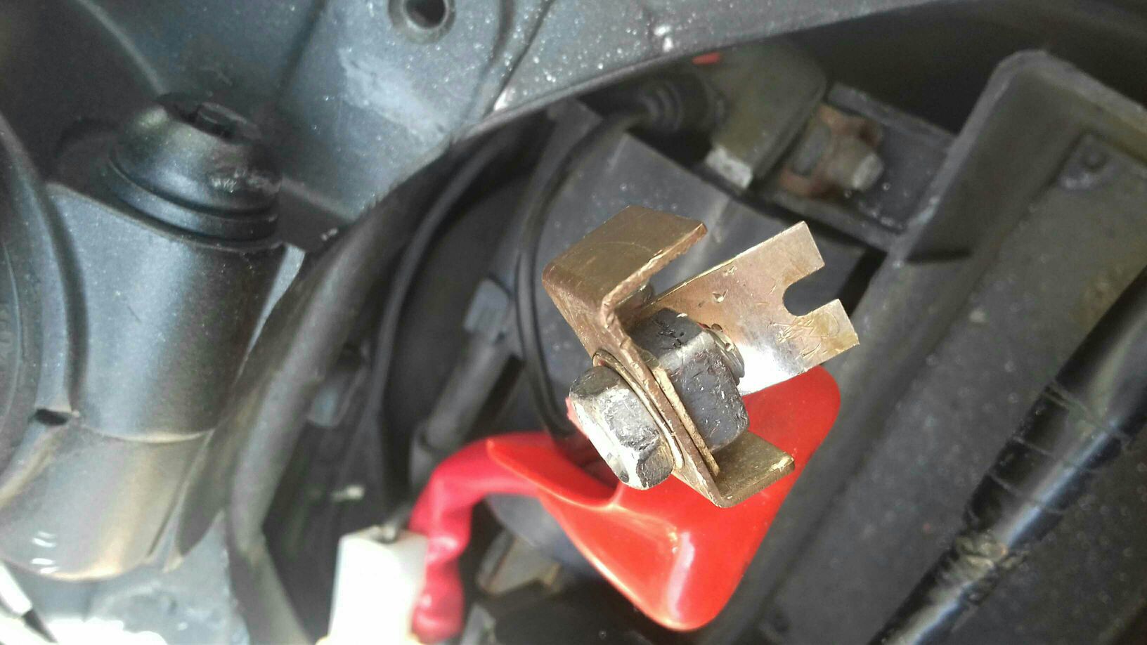

Thank you for the input. I tried drilling with moderate success. The terminal ended up breaking off and now I have the battery out but I still have take apart the connections. Once again the bolt seems to just spin. I tried clamping the remaining bit of the terminal, the connection, and the square nut snd turning the head of the bolt, with no success.

Simply un-bolt that cable from the starter relay(the other end) now.
Then clamp our "problem bolt" in a vise and drill / grind at the bolt till it's "dust".
As noted, sounds like the internal threads stripped...
Just don't tear up the cable end...

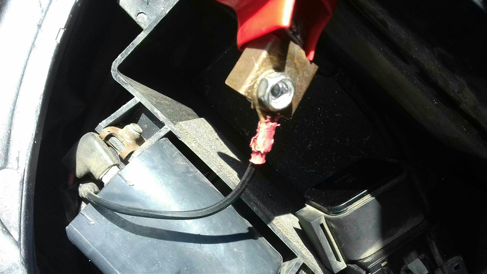

That was easy enough (thank you!) But what about. Other cable? I cannot see where to unbolt that

That's not a factory cable, probably a battery tender hook up.
You can still grind or drill the problem nut.
As for the "auxiliary cable", If you want to keep it (might not),
and you still have issues with your nut and bolt, simply cut the end of the added cable end off.
Replace it with a new end (available at all hardware stores)-Strip and crimp..

That isn't stock. Well that makes my life easier. Thank​you for all the help. I appreciate the patience with the rookie questions
