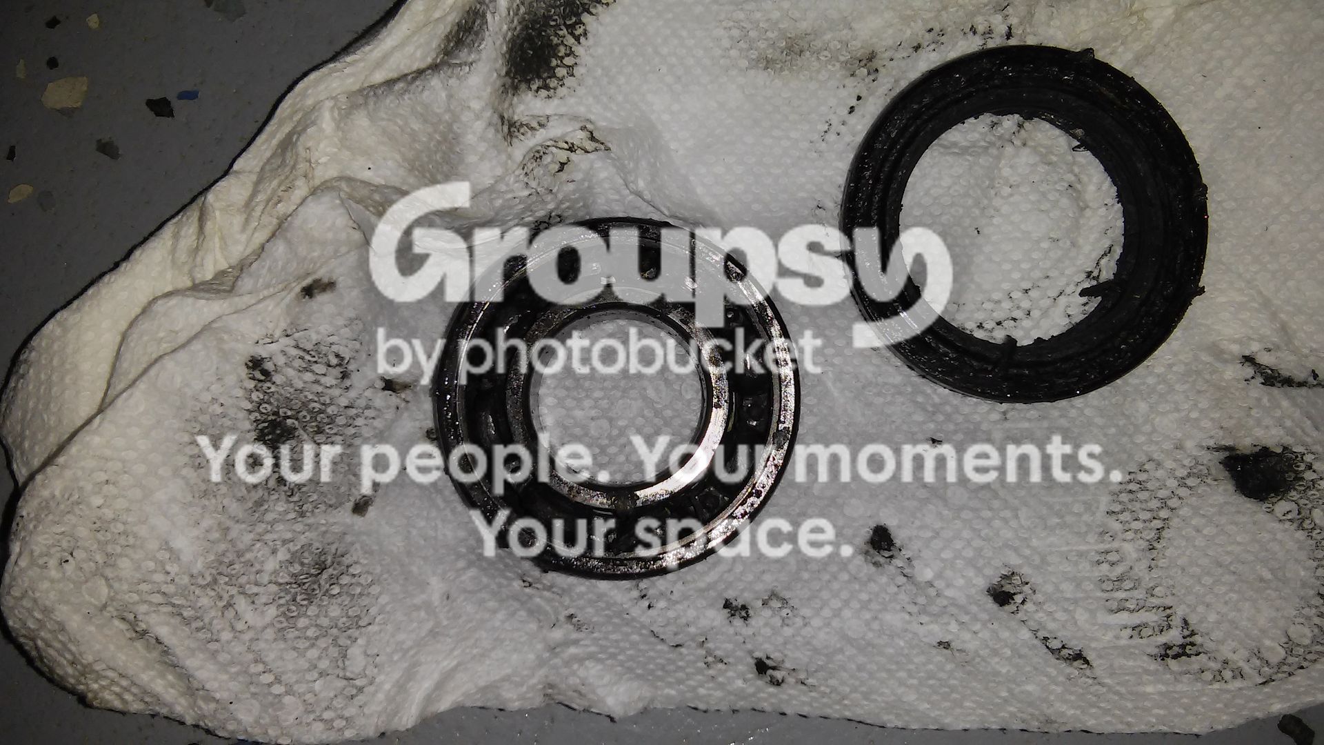

Ok, sorry I didn't clarify. But the rear wheel spins just fine when tight now. If I spin it, it will do a full rotation or two. If I slowly spin it, there are spots that have a little resistance, not a lot, I thought that was normal. I didn't think about the front sprocket orientation. I am not sure what made me pick one side over the other as the outside. Will take a look at that.
Also, I was looking at the pic of the wheel assembly when I took the axle off last night. All the bearings and spacers are in properly and the bearings spin freely.
