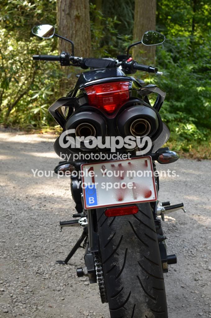

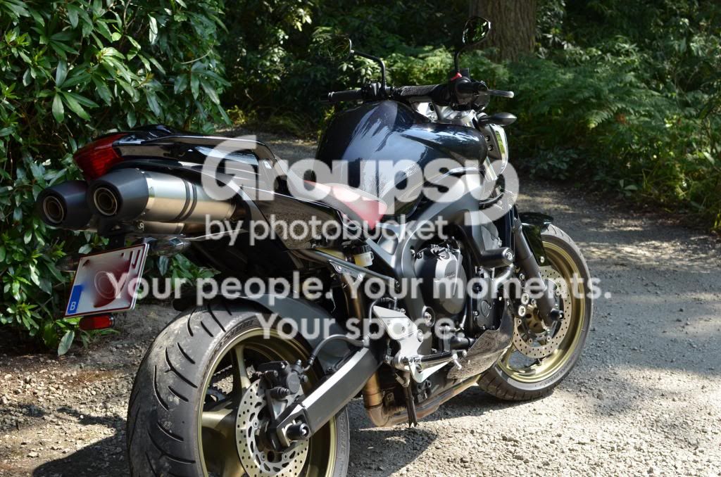

I might be a bit bias, but IMO the Leo Vince looks better, and i like the fact that it comes with Db killers, i don't think the 2 bros comes with them, although they are an option.
I have had the Leo Vince on my bike for a while and it runs fine without a tune, although i have to admit that it does pop a lot under decel, which could be a sign it's a bit lean.
I am not to worried about it, but am still going to get it on a dyno and try the Co tuning just for a laugh though!
