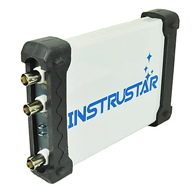

Once jobless, I may hook up and an O'scope and see if CO1 vs CO2 changes apply to 1&4 AND 2&3 or if its TPS dependent like the R6. Mind you the R6 has 4 adjustments which play against the whole TPS Range for fueling. Well, if you have the proper ECM! That said, I still don't see how OUR C1 vs C2 would be used to set fuel across 4 cylinders. It only has ONE SNIFFER and one mutual exhaust outlet. So if this is true, it makes it hard to tell which group of cylinders is rich or lean from hydrocarbon output perspective. I must know and I'll look but I have some other things to do in the mean time.

Hmmmm.... Data Logger O'scope
