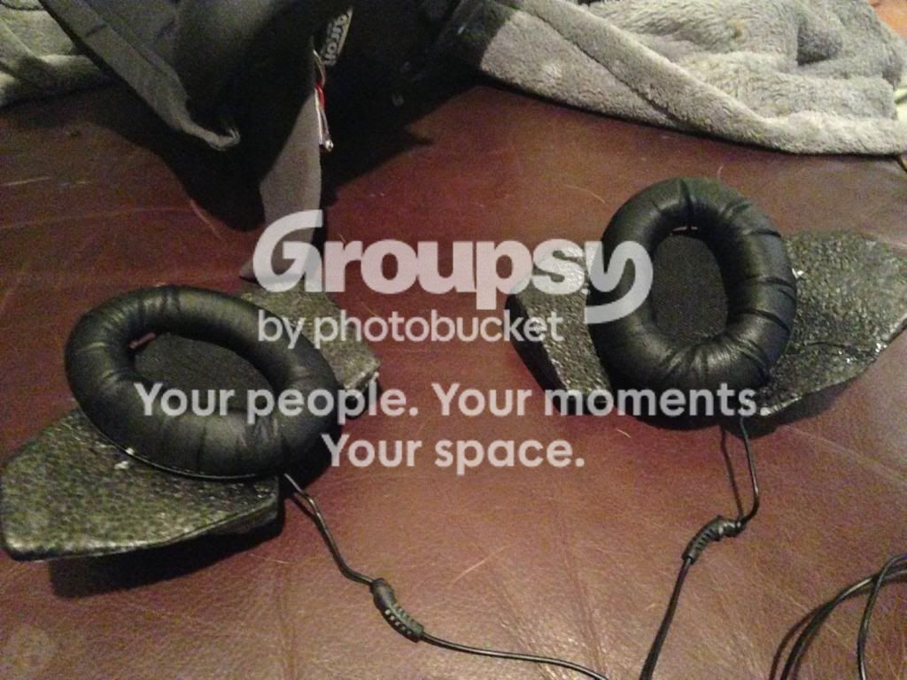

I looked into new earbuds and helmet speakers, but that would more than likely put me in the same position as well as cost me money. Well, to make a short story shorter I had a few beers and decided that the speakers in my Bose headphones would be better suited fixed to the inside of my helmet. So this happened...

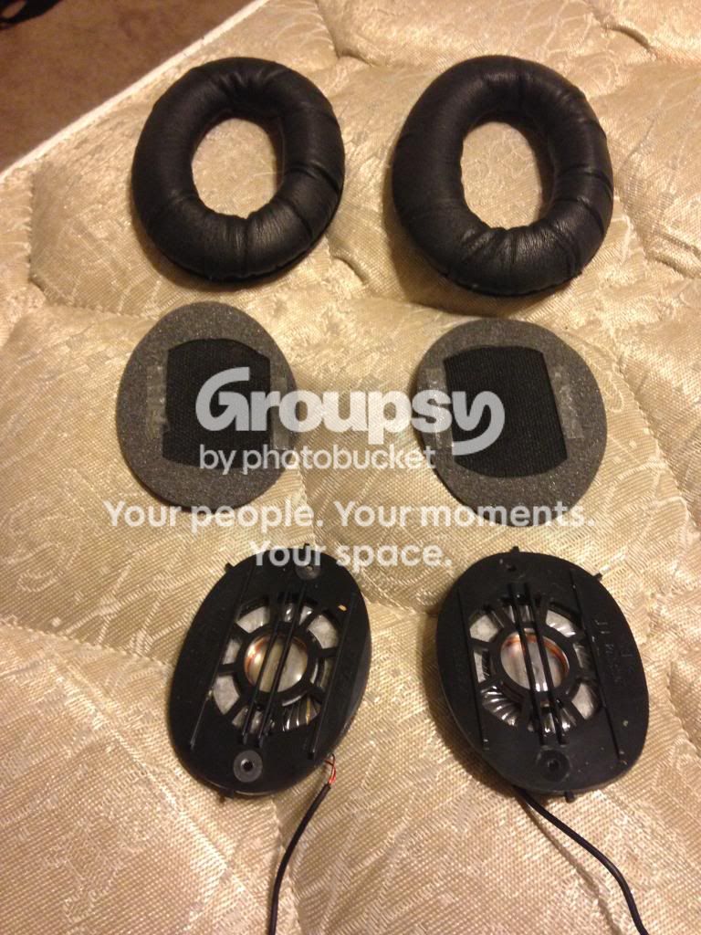

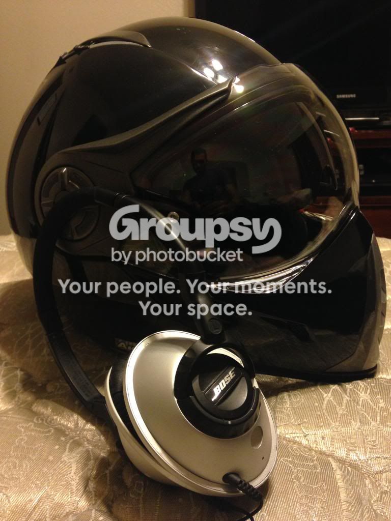

I threw caution to the wind and began by, not so gracefully, dismembering my headphones. There were pliers, and scissors, and whining, and brute man-strength involved.
I decided I would keep the ear pads and covers for extra sound isolation, and shoved the rest of the crap in the bin.

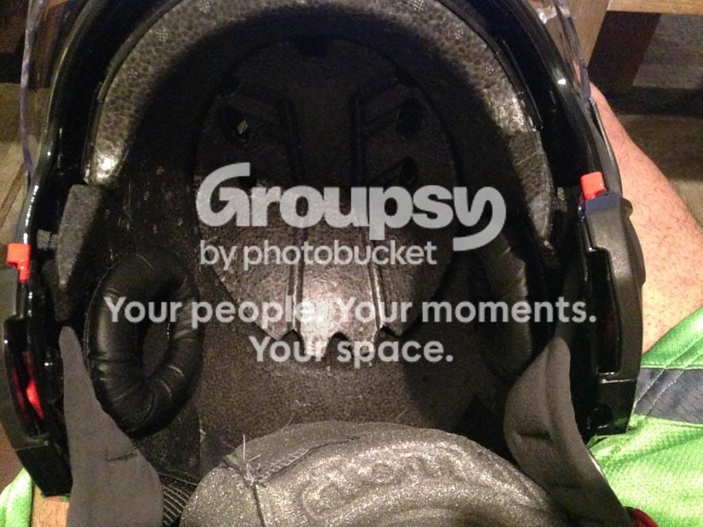

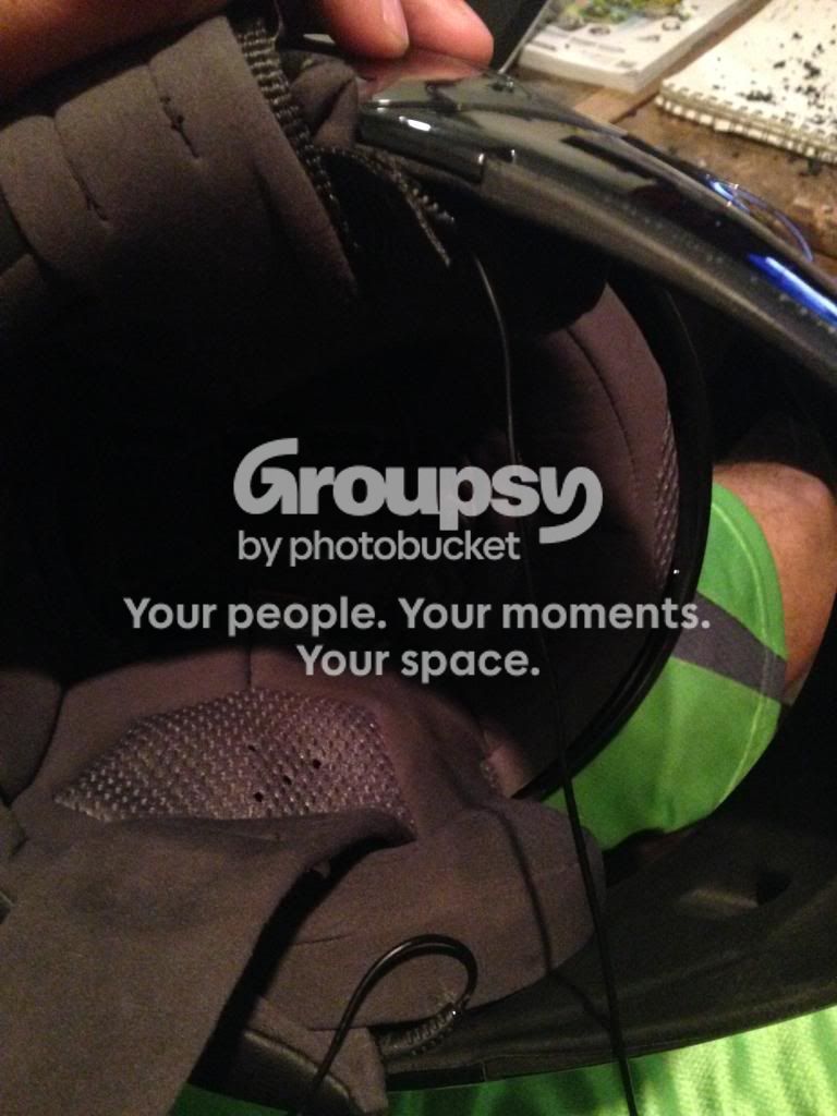

Then I carved out some space for the speakers in the foam over the ears. I was lucky enough to buy a helmet that doesn't have spaces already [/sarcasm], so I got to spend a few hours stabbing stuff with sharper stuff while watching terrible movies and not paying nearly enough attention to what I was doing.
After I was done furiously stabbing foam, I broke out the hot glue gun and proceeded to burn my fingers as a result of the aforementioned lack of attention. I also secured the speakers in place as a welcome side-effect. That was nice.
After that was done we had words... I took up cursing at the helmet until it put itself back together properly, and after being thoroughly shamed it did as it was told.
Once everything was finished I proceeded to put on the helmet and chase Tim the Dog around the house to the lovely sounds of Beethoven's Fifth Symphony at 5:30 in the AM. Luckily for him, he enjoys this type of rigorous activity, otherwise I would've had to have words with him as well. I don't like a dog who can't take a joke.

Funny! It looks like your helmet lends itself to this mod in that the ear sections look separate from the rest of the helmets EPS liner. Now how is the sound? :)
That was the only nice part about it. It would've been a real pain if they didn't.
The sound is amazing!

Yeah, I've seen those, but I can't really spend any money on extra things at the moment. I'd also decided against those because my helmet is really loud, unfortunately. Using the Bose speakers saved me the money, the pads act as sound isolators, and the sound quality is just insane. I cut a circular hole straight through the back of the foam pieces and it's like the speakers are using the helmet itself to increase bass response. Haha
I haven't used those headphones in years anyway. They were just collecting dust. At least this way they'll be used.
