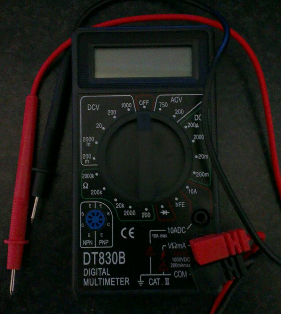

Hey all -
So the battery I replaced in April 2011 (scorpion) went dead today. I had ridden the bike probably 10,000 miles with it and had no problems. It normally lives on a battery tender but about a month before my trip to the dragon (september 2012 did 2500 miles) I took it off the tender to test if it would hold a charge. did well no issues then put it back on the tender.
Today I commuted to local locations with starts maybe 3 times when changing locations and a couple stops on the way home. Then did about an hour of mixed riding with very heavy traffic followed by a good cruising speed for maybe 20 minutes. I stopped about a mile from home and the bike wouldn't start. the pump primed and I got display but when hitting the start button the button just clicked.
Luckily I was able to easily roll start the bike and get home.
Once home I I hooked up this multimeter to the charging connector and
got 12.4 volts. When hitting the start button (clicks again) and drops volts down to 5.4 and won't start. After about only an hour on the tender the bike starts like nothing was ever wrong
Sorry for the long post but looking first off for advice on using this multimeter
1. The setting as shown in photo gives me voltage. What are the other settings used for?
2. Would a simple test of battery tell me if it is the battery or something else? ( it is entirely possible I just got a crappy battery off ebay).
Any help would be appreciated. I am pulling the battery out tomorrow morning to have it tested.

Charge it completely and have it load tested.
The volt meter is set in the 20 vdc range. That's perfect. You should read about 13 plus VDC when you have the battery charged and the rpm past 2000 rpm. Definitely have it load tested. The other features are for small amperage measurements, AC volts, Ohms and it has a transistor tester! LOL Only Harbor Freight! LOL I have the same cheapo tester test knocking around in my car. They're cheap enough you could buy one for each room! And for what they are they do work!
If you can get a cheap 12 test light. The kind that has the sharp probe and an alligator clip.Make sure all power and key is off when doing this test. Take the negative lead off the battery. Put the alligator clip on the end of the negative wire . Touch the probe to the battery negative terminal. The test light is now in series. Does it light? If it does light, keep the probe touching the Neg Battery terminal and touch the negative wire lead the the negative terminal on the battery. The light should go out. Now remove the negative lead keeping the test light attached as before. If the light goes out and stays out there is no leak, meaning current is not flowing and draining the battery. If the light stays on there is current leaking and this is discharging your battery.

Thanks again Moto. I tested the negative lead as you said.
Good news no leak. The battery is the probable cause.
After a full charge the battery registers 13.2 volts. I suppose the load test will be telling.

Before you rely on this Harbor Freight multimeter too much, open the case using the 2 screws at the bottom rear, and check/replace the internal battery. I very recently checked my FZ6 battery voltage, and got a reading of 16.x volts! That reading was pretty consistent over several checks. Made me a little nervous. Ran downstairs, grabbed my expensive analog meter, and the average of 3 or 4 readings was "about" 12.6 volts (analog not as "exact" a meter).
Turns out the Harbor Freight meter comes with a really cheap OEM battery. Mine failed after about two years of mostly storage and very light use (your mileage may vary). For whatever reason, I got crazy voltage readings (crisp, digital readings but absolutely dead wrong) as the battery started to fail. Took a few minutes, replaced the battery with a Duracell using the two screws at the bottom rear of the case, and now no problems with the meter whatsoever.
Note that Harbor Freight seems to sell these meters for anywhere from $2.99 to $11.99 or so. I picked up several at the $2.99 price, and they're absolutely identical to the more expensive ones. In fact, at my local store if they have them in 2 different locations within the store, they're likely to be at 2 different prices. I do have an excellent analog multimeter which I've had for more than a decade, but when you need a digital mulltimeter and want it on the cheap, you simply can't beat this Harbor Freight gizmo. Would make a fine Christmas gift for your riding buddies. You don't have to tell them it cost less than $3.00!

Multi meter
I've got myself a multimeter and it came with some fantastically detailed instructions.
Sadly they are in Chinese.
All I want to be able to do is test a circuit and check the battery.
What setting do I use?
Neil:thumbup:

Change the red lead where it enters the multi meter when checking for ohms and change it back when testing vdc
You are only as good as your test equipment if you don't use it right I will give false results causing you to trouble shoot incorrectly
