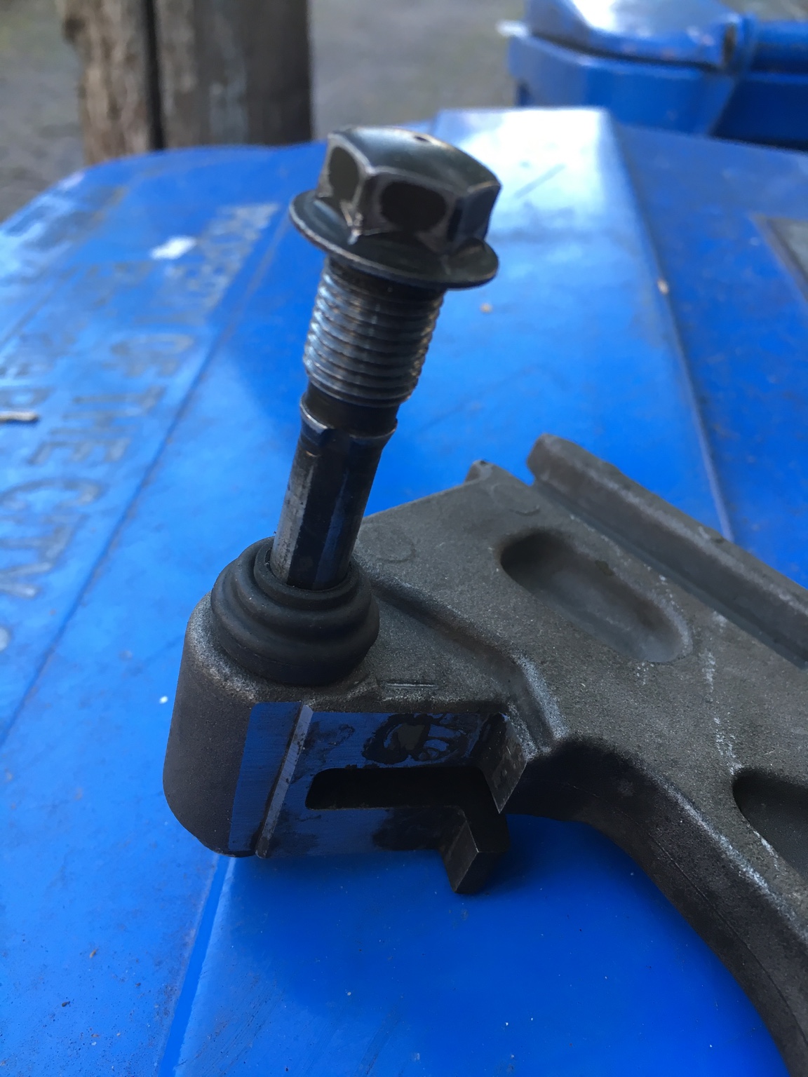

The bracket does look straight when I had it next to a piece of glass.
Runout looks good too.
https://vimeo.com/167662570
Also, the wheels never really left my sight, I have a friend who does the tire change!
This is the bracket on a glass table top:
I'm not sure what I could measure as it is machined in a way that prevents it from being "flat."

It does look good from here, but I'm talking about .002-.005 " A bike pedal really isn't best. Even if you can hold a thin pointy scribe, tiny drill bit, etc to the surface would be more accurate.
Seeing what you posted I don't think you'll find it messed up
(You don't have to video tape that, just rule it out)
BTW, you always had to run the front bolt in with at least a tool of some sort, didn't you?
It really should spin in just like the rear one, literally by hand. With ruling most everything out, (scratches head)

Re: Rear Brake Super Soft After Wheel Removal & Brake Work
Really odd, with all you've checked, been thru but that front bolt, ahhh...
I gather threads in the main bracket(front hole) appear ok.
durty3
2004 Yamaha FZ6
Apr 21, 2014
39
Chicago
The threads in the caliper look fine, but no threads in the bracket, the bolt just floats in the bracket.
12,539
1,186
Yep, my boo. Did you clean real good inside that boot, get out any grit, re-grease?
And that boot, shown ^^^, was nice and straight, not partially in either the bracket or caliper correct?
^^Where this bolt goes into the main brake bracket assembly....^^If the bolt does not pass through that hole and bottoms out in the hole it would c0ck the caliper in the main brake bracket when threaded in. Could this hole have crap in it? The end of that bolt should not bind in that hole and should either pass through it (if not a blind hole) or be able to pass to full depth of the hole. I don't see a washer or spacer in the diagram that would limit the thread travel of the bolt at the head. If there was a spacer/washer it would not allow the bolt to travel as deep. When the bolt is in the hole the problem occurs.... :)
