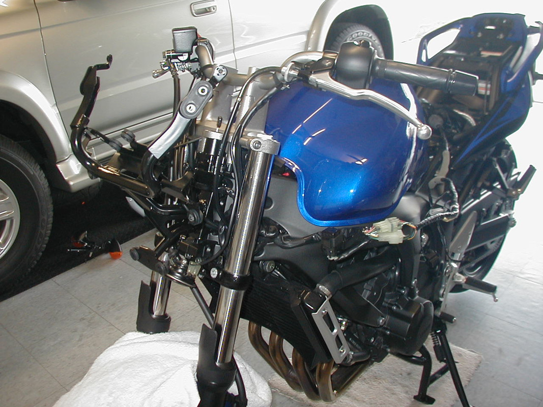

12,531
1,176
While we are talking headers, has anyone heard of JetHot ceramic coating? I have an extra set of headers that I sent them to coat. Expect them back end of this month. Cant wait. Hope to challenge Scott for the title of Worlds Best Looking Headers! [emoji3]
Keep trying!!! LOL.. :)
All it takes is a nasty street, wet, to kick up crap and make them crappy looking.
Mines a "pleasure" bike so really doesn't see rain un-less I get caught un-expectantly..
I might do a quick clean up twice a year...
The Jet coating (if it's the same as the other ceramic header coatings), is supposed to lower exterior heat and give better engine performance (likely VERY slight).
This is my bike (replacing fairing stay) when I first got it in 2009.
You can see the header was NASTY, (the PO NEVER washed the bike ever!):
