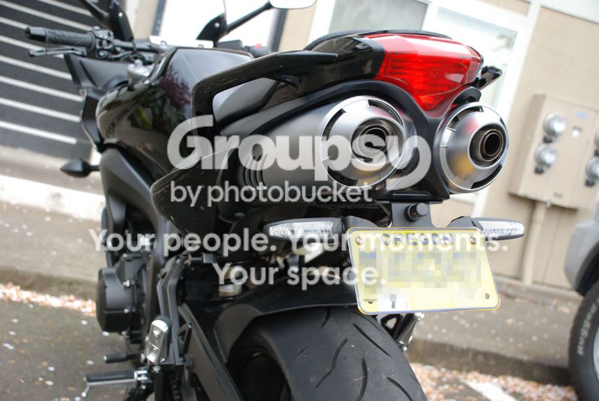

Quick recap of the plan.
First off, the plan has changed, but I'm going to chop off 85% of bracket purchased and use the mount section to secure the plastic under the grab handles. This will keep the tail section from flopping in the breeze and secure the pods once again.
FAB up a new Tail Tidy from 0.125" aluminum plate and powder coat it. I had this Evotech unit on the stock muffler, its simple and it works great for that, so, something like this I suspect but for the 2B's.
DSCDSC_5093TailTidy.jpg~original
Like BD did, a simple heavy gauge wire rod will support the TT and keep it from flopping. That's the plan so it will mount under the seat to the flat pan (pic) and form a triangle to keep the TT from bouncing.
IMG_20130610_182303_WEB_zpsbd7f60ed.jpg~original
Now to sketch up something and chop it out. Moving useful data to new thread.... And get rid of this!
