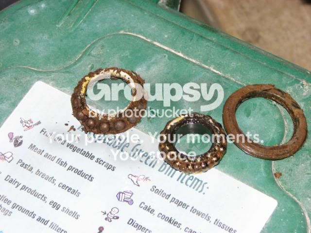

Similar experience, mine were shot (see pic below) at ~16k km. Replaced with All Balls and didn't even touch them until I sold the bike 100k km later
^^^ Ick. I'm convinced that Yamaha installs muck into the steering bearing during assembly.
Mine were the same too. All of my bikes except for one all have All Balls bearings; head tube, front and rear wheels.
Not to derail - but based upon the population, it seems like a very small percentage have lost the head bearings. :don'tknow:
Rust is not a bad bearing. Rust is a Product of contamination from Failed seals.

I've always suspected it was due to a design flaw in the seals. I know I've seen some similar condition bearings posted before. Here's an example at 7000 miles, My steering head bearings are officially shot. - Sportbikes.net
There's no real other explanation of why so many other FZ6's have needed new steering bearings. Definitely wouldn't say it's everyone, but it's also not a small percentage.

I agree, back in 2007-8, this was a very popular subject to a point I thought that Yamaha should have just done a recall on the bikes. The only reason why the subject doesn't come up anymore is because there aren't anymore new FZ6's introduced into the family.
