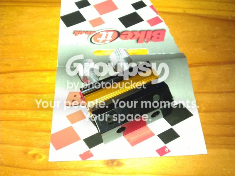

Some additional pic's that wouldn't post above:
Thanks Scott. Seriously, you are arguably the most helpful person on this forum. You've replied to my questions accurately, in high detail and quickly in the past, and this is no exception. Thanks a million! :)
I have purchased a two-screw lubing tool now, although I had to adapt my search strategy to get UK suppliers as their called "cable lubricators" over this side of the pond....a bit more formal I guess. ;)
I'll track down some suitable spray soon, replace the cable (I bought two, just in case!) and maintain it properly this time.
Cheers mate.

Tiny little things aren't they? Don't know why, but I expected it to be bigger.
