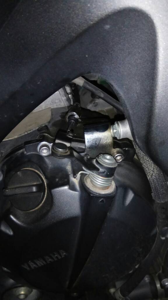

Yep, you should NOT have to remove that arm, period, just bend that little retainer at the end of that arm.
There should be two marks, one on the case (more of a triangle) and one on the arm. When assembled and clutch adjusted correctly, they SHOULD LINE UP.

It should work the way it did before but easier... It isn't slipping, it isn't disengaging.
You didn't pull the little "arm/lever" at the engine did you?
Yup, I put the bike in gear, squeezed the clutch fully, and I couldn't rotate the back wheel by hand, it felt as if the clutch wasn't actuated at all.
The arm/lever looks aligned ok, right?

That's working correctly, thanks...
