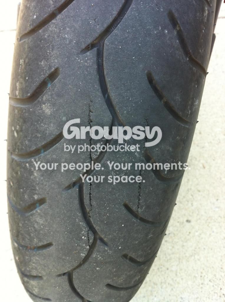

Hi guys I recently bought a 2007 FZ6. Ive been having a blast so far, except for today after I went for a ride I noticed there were two cracks on the front tire.
Should I be worried about that. The tires have lots of tread on them should I still OK to ride or would it be unsafe until i get new tires?
Do you think these cracks happened when I was riding the bike Just curious because when I was looking over the bike for the second time after I brought it home I didn't see those obvious cracks.

I'm not one of those who categorically say, "Go buy new tire" but yours looks like, as mentioned already, something is separating with the rubber compound. What kind of tire is it? Is that Bridgestone? What model? Check manufacterer date yet? Does NOT look good to me. Looks dangerous (and I will ride with a inner belt showing on a very high mileage!)

They look more like cuts than cracks to me because they don't continue through the grooves. From the perish lines in the bottom of centre groove that tyre is either old or has been run near flat.
A rear blow out is scary but a front blow out at highway speed can easily be fatal as you are unlikely to stay on the bike.
As much as I hate waste, I would bin that tyre ASAP.

Tire code : 9APM5206 (that means the tires were made in 2006 correct?)
My tires are made by Dunlop and they have 3700km's on them now. The previous owner put about 3500km on them.
Since it could be dangerous running with these tires any longer what kind of tires should I look into getting. Also can I just swap out the front tire since the back tire looks fine?

With that date code means those are the OEM tires and I would replace both ASAP. Lots of tires threads on the forum, just do a search, but looks like some of the Michelin offerings are getting good reviews. I ran Bridgestone BT023's on my FZ6 and liked them a-lot, not the best mileage out there but they stuck good.

Agreed, looks like a cut to me and I'd park it!
12,539
1,186
The separtion is NOT very straight and getting two "cuts" next to each other as such from road debris is highly un-likely.
IMHO, that tire is separting, just worn out...
In either case, I'd be replacing that tire ASAP, it's really NOT the consequences when it DOES LET LOOSE... (crash, damge, injuries, plus a new tire anyway!)

Yep, 5206 = 52nd week of 2006. That is the original Dunlop D252.
If the rear is the same vintage as the front, it should be replaced, too.
Look for a quality brand Sport Touring tire for all purpose riding if you aren't sure what to look for. Browse the tire threads here and the reviews on online shops. What you get may come down to your budget and what's available to you. From memory (always a dangerous thing) these get mentioned most often in the forums, with positive comments.

You'll be grinning when you feel how much better this bike behaves with new tires. Not many riders liked those D252s, even when new.

I downloaded this tire picture so that I could zoom in on it and it definitely has signed of dried out rubber if you look at the grooves. The tire probably impacted something on the roadway that didn't actually cut it but caused separation because of lack of elasticity.
Those tires are done!!!
