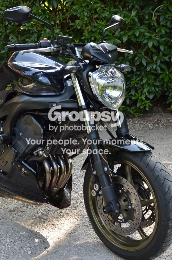

I wonder how the reflector will deal with that, keeping in mind this is my headlight:
Will the fact that that the light is only coming out of a half be cancelled by the reflector, or will i have a crappy beam on low beams?

It looks like the diode is pointed upward/downwards,s o it should hit the reflector and actually provide some varying spread of coverage.

yeah, i imagine the lower one would be for the low beam, and both would be for the high beam...
Would the reflector be good enough to compensate the fact that light is only coming from the bottom though?
