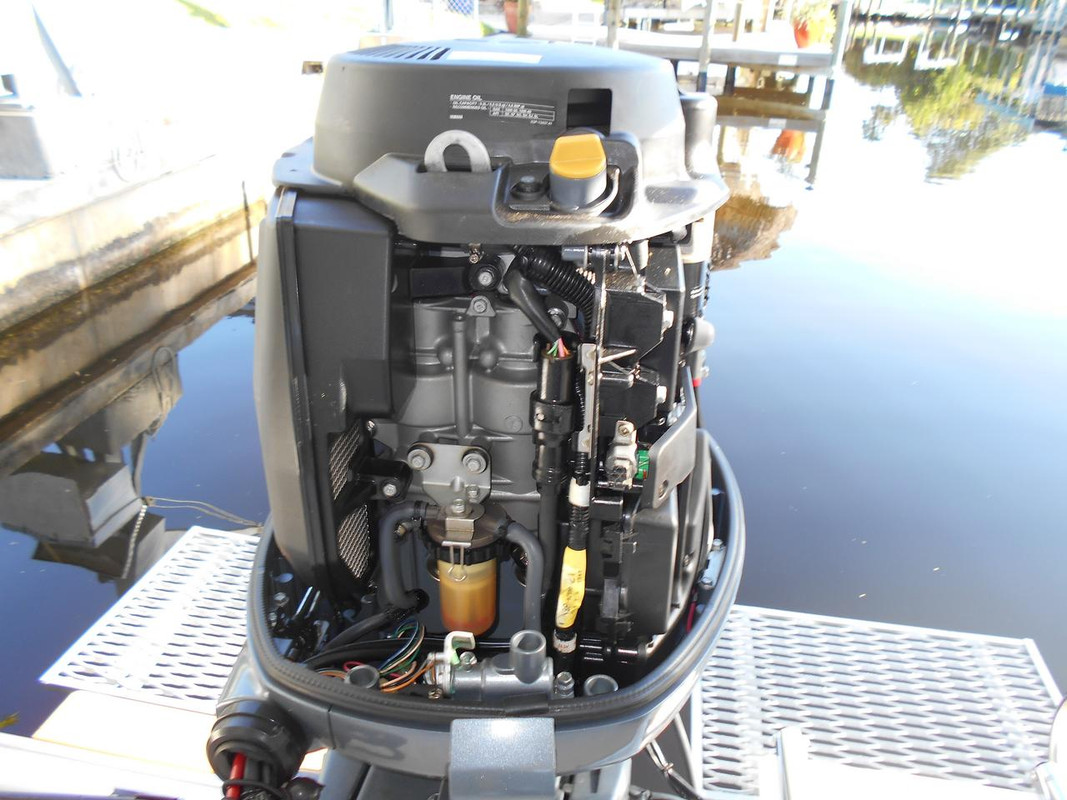

With my 2006 Yamaha F150 Outboard engine, I've come across exactly this. Specifically with a under cowl fuel cup. The newer version has a sensor to monitor water in the fuel system (the cup is well over $100, my cup, NO SENSOR, about $12.)
You can see it dead center between the balancers:
