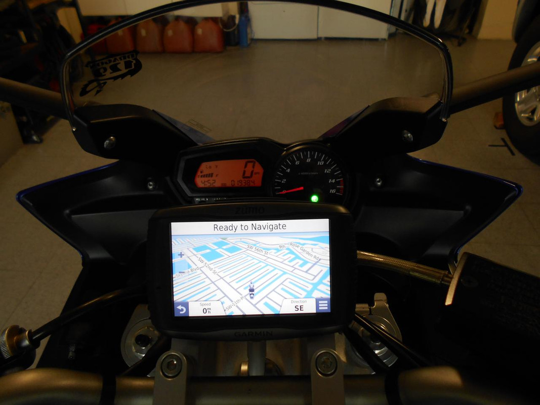

An S2(07 and up) has BOLT ON rear subframe passenger pegs-The bracket is NOT WELDED TO THE FRAME(SEE BELOW- my '07) The dash is also different, second pic is an S2 dash(not with the GPS)
If you can post some pic's here, it'd be easier..
