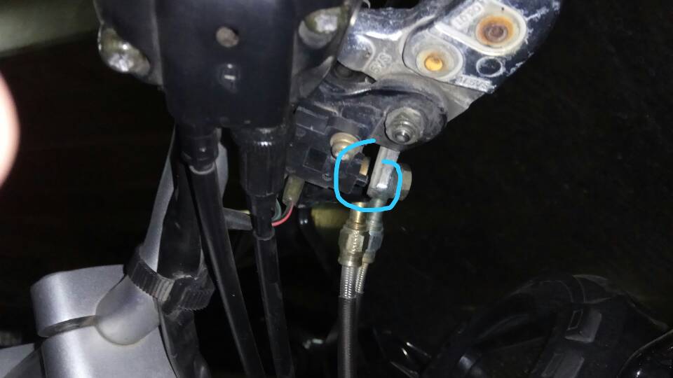

Arrrgh! - looks like my front brake light switch has failed, AGAIN. This is the second one in 17000 km ~ 10000 miles and to make things worse it looks like I broke my one of my Cardinal rules to "Never, ever throw anything away" :D and threw the old one out even though I had dissasembled it and (at least so I think) repaired.
I ride rain or shine so I guess the weather did it's thing but damn it these things should at least be more durable. It's cold&windy and my bike is parked in a drafty public garage so I'll report back once I've taken a closer look.
Anyway, thanks for reading and if anyone had a similar problem please let me know :thumbup:

Update;
After some fiddling with it I realized the little plunger that is actuated by the front brake lever was stuck, considering it's positioned in a place that takes the full blow of the weather&road grime they could have make the thing a little sturdier.
Fun fact; when I press the rear brake only the stop light shines brighter than when I press the the front brake only. Go figure

How much difference in brightness? I would guess there could be some difference but there should not be a great deal of difference. You could have unusual voltage drop due to resistance somewhere that is abnormal.
It's quite noticeable - can corrosion/oxidation on the contacts cause the resistance? The front brake switch is from ebay so I guess the cheapo metals used for the contacts could cause it too?
I'll try disconnecting the switch and connecting the wires that go into it directly to rule the switch out.

It's quite noticeable - can corrosion/oxidation on the contacts cause the resistance? The front brake switch is from ebay so I guess the cheapo metals used for the contacts could cause it too?.
Absolutely. Burned up contacts don't pass make for a good connection...
I don't buy knocks offs... Save a couple of bucks and the thing fails / doesn't perform like OEM..
