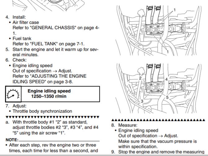

Have you tried opening up the Main, #1 TB adjuster some? As I re-call, it should be about
1 full out from seated. If this screw is too tight, you WILL loose the ability to adjust the idle
with the idle screw..
Everything your posting points to the TB's.
Are you adjusting the TB's per the Yamaha manual?
As such:

Well, TB synchro module checked:
Everything seems to be ok, the cold temp circuit moves freely and acts at 55 degrees celsius, the screws for adjusting are ok and the iddle cylinder moves freely too. There was only some dirt (not too much) in the body and in the edge of the needles.

  • I mounted the adjust screws at the same turns it was previously and the result was the same
  • I unscrew all 2/3 turns and the bike was revving better when warm but if you stop it you cannot fire again. Gaining some control of the iddle screw
  • I returned to a "starting point": full in and 3/4 of a turn out and it fired again when warm but with some stalling. Poor iddle screw control

If you don't want to purchase a manometer, you can make your own. There's many posts on it, here on the forum- IMO, that's more of headache than it's worth, you need to get some gauges on the TB's.
I'd probably start looking around for a set of used TB's(complete). Some of the crap initially found probably made it into that block (as you've checked elsewhere) not allowing ANY adjustment at the block.
BTW, those tuning screws on the block are EXTREMELY SENSITIVE. Just "winging it" /adjusting blind pretty much, WILL cause running issues.
Last TB sync I did, I sync at idle and at 4K and fine tune for the closest. That usually takes me 1/2 hour (large fan in front of the radiator) and as stated it takes VERY LITTLE to move a sync high or low..
