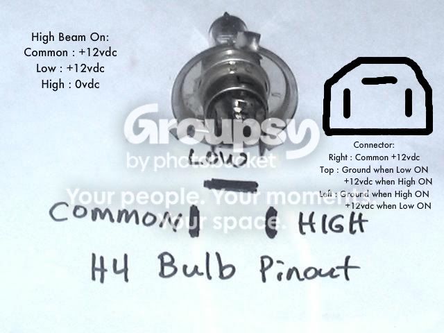

The bulb is H4 type, voltage is passed to the bulb connector when the engine is running. Bulb is structurally intact and there's connectivity when testing with a multimeter between legs, I don't see anything wrong with it.
Bulb connector has three wires: black, black/green, black/yellow. According to the wiring diagram black/green is high beam, black/yellow is low.
When the low beam is ON, voltage is supplied to black/green (high beam??) wire, when the high beam is ON, voltage is supplied to BOTH, black/yellow and black/green wires. Also, when the bulb is plugged in, no matter what beam setting on the dimmer switch, high beam indicator is light up in the dash.
Now according to this H4 pinout "diagram" I've found my understanding is that voltage should be supplied to either high or low beam wires and never to both, is that correct?
In this case, am I likely to have a faulty headligh relay? Visually headlight relay looks identical to the radiator fan relay, I'm entertaining the possibility that these were mixed up and I'd try to switch them places, any thoughts on that?

I'm now thinking it's the bulb, will buy another one and see if it helps. I've found a test procedure with a multimeter
no resistance between eighter beam pin and ground
infinite resistance between beam pins
I get no resistance between them all.

The H4 side should only have two wires going to it unless you have done a headlight mod to it. The two wire colors are black and black/yellow. The black is battery ground so if you were to measure the voltage from that black wire at the connector to the negative of the battery, you should see 0v. Anything more and that tells you that the ground is bad.
When the bike is running, and the high beam selector switch is on high beam, there should be voltage from the black/yellow wire to the black wire or to the negative of the battery.

Yeah, I'm using an MT03 headlight with H4 bulb, unless I messed remembering the voltages supplied are as specified below (running engine)
When the low beam is ON, voltage is supplied to black/green wire, when the high beam is ON, voltage is supplied to BOTH, black/yellow and black/green wires. Also, when the bulb is plugged in, no matter what beam setting on the dimmer switch, high beam indicator is light up in the dash.

Are you sure? Having connected this way (according to the manual) I get high/low beams as per dimmer switch setting. Maybe 07 bikes have different wire color codes as well as changed manual?
If you follow the black/yellow wire from the bulb back up to the switch in the wiring diagram, it connects to the high beam side of the switch. This is the same wiring diagram for all the years. The label would appear to be wrong for the 2004 and 2006 manuals.
That makes a lot of sense and was the cause of my confusion seeing voltage always supplied to the "high beam wire" (if the manual is wrong it should be low beam as you state). I'll go and fix this now.
By the way, any place where these revisions/errata are documented?
EDIT: you were right, thanks for letting me know now, you guys saved me a failed MOT test. No idea why I thought hight/low beam configuration with black/yellow as low beam feed was correct, not enough clearance in garage to see properly maybe...
