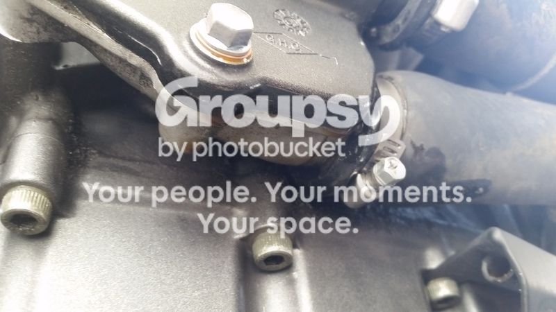

I've been leaking oil for several months now, nothing serious, just a small drip but since the weather is nice, time to take care of the problem. It appears I just need to purchase a new hose clamp and screw, since the stock clamp and screw doesn't tighten any harder. If that's the case, will any hose clamp and screw from Lowe's or hardware store work? Or should I get a OEM replacement. The hose is still stock, I'm guessing it really needs to be replaced, but I can't find the part number of the hose. I want to see if a new clamp will stop the leak, if not I will have to replace the hose.
Scott, Randy, your thoughts?
14,992
1,158
That's your water pump.... Could the oil be dripping from above the hose? That clamp and hose might be okay. Maybe the clutch cover gasket....? Also I know your crank shaft position sensor and other work was done previously so maybe that cover....

Waterpump, well that helps as far which clamp and hose. I think #22 & #13. The hose directly above the bottom one, which appears to be leaking from the clamp is not leaking, and I don't think it contains oil, maybe radiator fluid.

Maybe it's even a combo of coolant and oil? Hit it with some S-100 cleaner and pressure wash it right there so it's clean. Then you may have a better look at what's seeping and from where. If you see an oil drip on the ground you know it's an oil leak.
You should have that looked at on the 125,000 check up! Blah

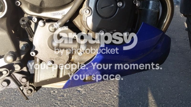

Looks like oil, looks slow. So slow it can attract dirt and debris and coagulate! Clean it as Cliff suggests and look up from the bottom.
Although it also looks like drain bolt is seeping on the WP housing too. Could be WP seal or WP to case seal. Look up from bottom!!!
Also, don't it look like the WP hose is nearly sliced from the clamp? Unless thats the protective cover slid back too far?

There is a slight drop of coolant in the first pic. That hose also appears to have expanded a bit(likely needing replacing). Replacing the clamp is just hiding the problem, I'd address the issue itself..
That oil leak has to be the oil seal slowing giving up.
IMO, with the high miles you have on the bike, rebuilding the water pump (bearings inside too) and replacing that hose would be a good investment.
You don't want that pump letting loose in the middle of no where...
But what if OPs coolant is black and nasty and the hose which looks like a snake with rodent inside is about to burst?
Thinking back, ive seen coolant leaks be black an nasty like that, so two votes for hose replacement as its only the suction hose (top center hose) with the extra jacket so what i thought was the jacket slid back is really your hose failing....

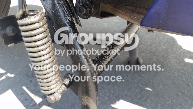

If the oil seal is failed, oil will also be leaking through the weep hole. Your case might be contributed to many factors, hose, oil seal, water seal and the bottom cover blocks the wind so oil drips everywhere else. (I rode mine without cover so the wind blew oil to my center stand's spring, oil pan..etc it's nasty leak!).

I removed the lower cowl and cleaned the area with a pressure washer, rode the bike a bit and it's definately leaking oil. A very slow drip.
Eventually, the undercarriage and side of the bike will look like this so I have scheduled an oring replacement for the water pump, along with a new hose. They mentioned that they would have to replace the radiator fluid.

It must have been oil seal failure. :eek: it will leak and leak until repaired!
It's pretty easy DIY! (well, I learned the hardway LOL, as I destroyed a set of oil seal, water seal and bearing).
Oil should not be leaked out otherwise it oil seal failure allows oil leaks through the weep hole and drips down wherever you are seeing it now.
I knew it since I messed up my water rebuild, I installed the oil seal improperly. That caused the oil got into the weep hole and leaked out there.
Save yourself, get the oil seal, water seal, orings and replace those. (in order to install the oil seal correctly, water seal must be removed so can't be re-used!).
